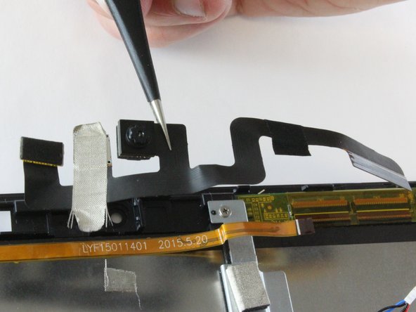

  10. Acer One 10 S1002 145-A Screen Replacement, Camera: crwdns2935265:010crwdnd2935265:01crwdnd2935265:03crwdne2935265:0 Acer One 10 S1002 145-A Screen Replacement, Camera: crwdns2935265:010crwdnd2935265:02crwdnd2935265:03crwdne2935265:0 Acer One 10 S1002 145-A Screen Replacement, Camera: crwdns2935265:010crwdnd2935265:03crwdnd2935265:03crwdne2935265:0
    • Separate the adhesive cable from the underlying copper ribbon cable.
    • Gently pry off the camera from from tablet backing.
    • Remove the camera and set it aside.

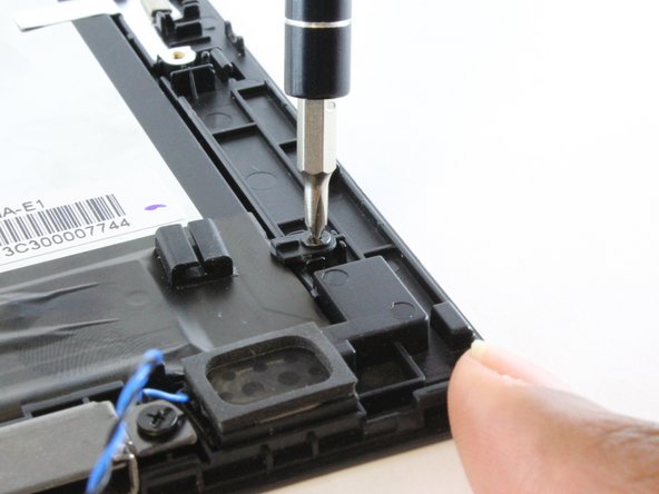

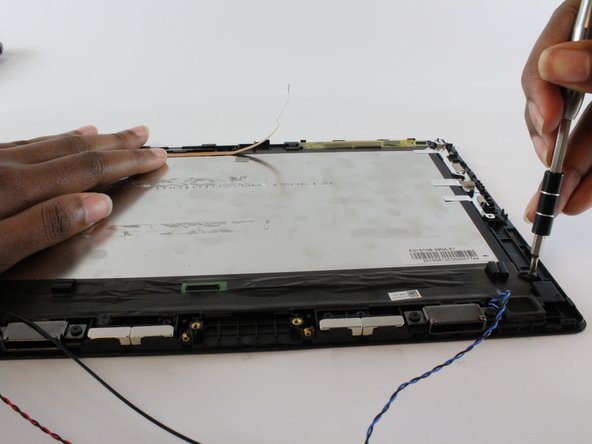

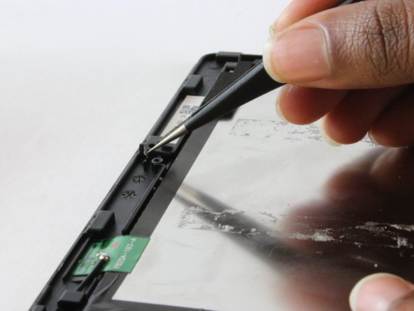

  12. Acer One 10 S1002 145-A Screen Replacement: crwdns2935265:012crwdnd2935265:01crwdnd2935265:03crwdne2935265:0 Acer One 10 S1002 145-A Screen Replacement: crwdns2935265:012crwdnd2935265:02crwdnd2935265:03crwdne2935265:0 Acer One 10 S1002 145-A Screen Replacement: crwdns2935265:012crwdnd2935265:03crwdnd2935265:03crwdne2935265:0
    • Remove the three 3.5mm screws from the outside perimeter of the tablet.
  13. Acer One 10 S1002 145-A Screen Replacement: crwdns2935265:013crwdnd2935265:01crwdnd2935265:03crwdne2935265:0 Acer One 10 S1002 145-A Screen Replacement: crwdns2935265:013crwdnd2935265:02crwdnd2935265:03crwdne2935265:0 Acer One 10 S1002 145-A Screen Replacement: crwdns2935265:013crwdnd2935265:03crwdnd2935265:03crwdne2935265:0
    • Remove the three small latches that are underneath the screws.

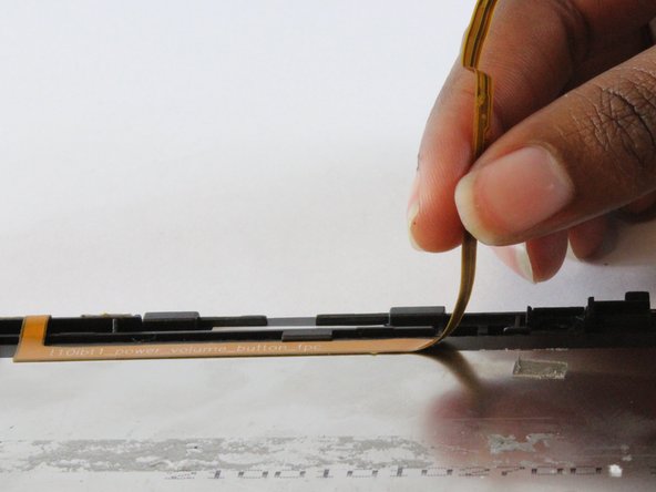

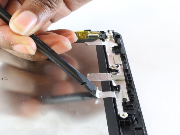

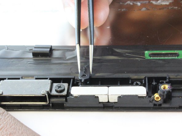

  14. Acer One 10 S1002 145-A Screen Replacement: crwdns2935265:014crwdnd2935265:01crwdnd2935265:03crwdne2935265:0 Acer One 10 S1002 145-A Screen Replacement: crwdns2935265:014crwdnd2935265:02crwdnd2935265:03crwdne2935265:0 Acer One 10 S1002 145-A Screen Replacement: crwdns2935265:014crwdnd2935265:03crwdnd2935265:03crwdne2935265:0
    • Peel the silver tape on the side of the tablet using the nylon spudger. Do not completely remove the tape.
    • Peel the gold tape gently. Do not completely remove the tape.

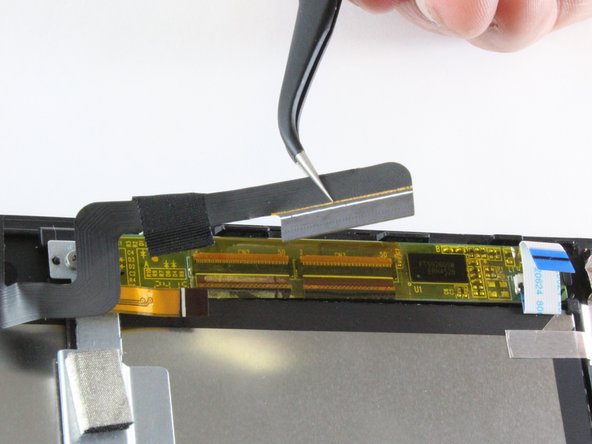

  15. Acer One 10 S1002 145-A Screen Replacement: crwdns2935265:015crwdnd2935265:01crwdnd2935265:02crwdne2935265:0 Acer One 10 S1002 145-A Screen Replacement: crwdns2935265:015crwdnd2935265:02crwdnd2935265:02crwdne2935265:0

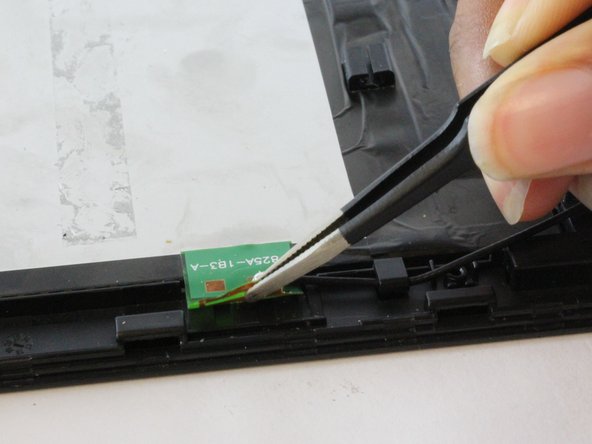

    • Locate the small green connector with the black cable attached.
    • Disconnect the black cable from the small green connector using the precision tweezers.

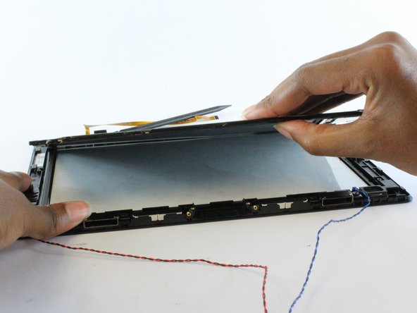

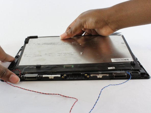

  17. Acer One 10 S1002 145-A Screen Replacement: crwdns2935265:017crwdnd2935265:01crwdnd2935265:03crwdne2935265:0 Acer One 10 S1002 145-A Screen Replacement: crwdns2935265:017crwdnd2935265:02crwdnd2935265:03crwdne2935265:0 Acer One 10 S1002 145-A Screen Replacement: crwdns2935265:017crwdnd2935265:03crwdnd2935265:03crwdne2935265:0
    • Using the nylon spudger, gently pry the LCD from the screen.
    • Once separated, gently lift away the LCD from the screen.
    • Place tablet screen to the side.
