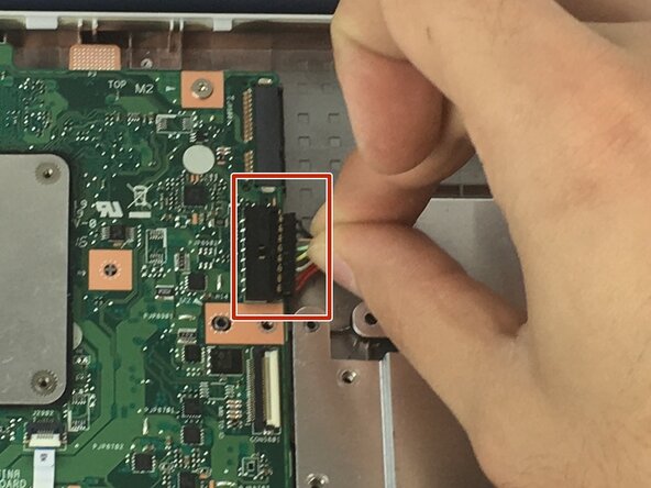

  • Use the point of a spudger to push on alternating sides of the connector to "walk" it out of its socket and disconnect the battery from the motherboard.
  • It may take a lot of alternating before the connector comes out. Be patient.
  • If that doesn't work, grip all the cables at once as close to the connector as possible and pull the connector slowly and steadily out of its socket.
  • Lift the battery from the bottom edge to to remove it from the Chromebook.
