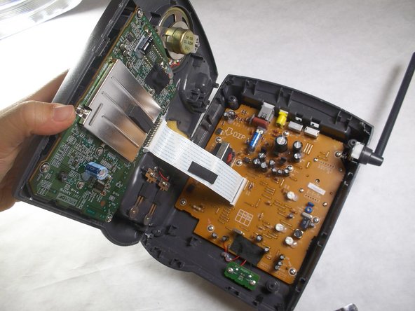

  • Locate the charging component towards the bottom of the grey, plastic, phone-shaped extrusion. It is composed of two metal pieces; each is fastened by a 5mm Phillips #0 screw.
  • Remove both 5mm Phillips #0 screws to release the metal pieces.
