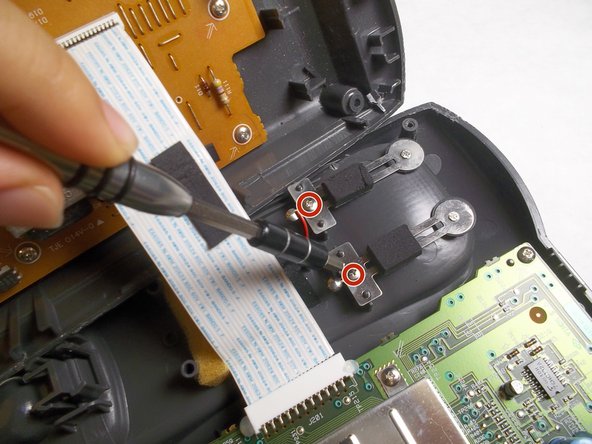

Charging Component on the Base Replacement
  1. Charging Component on the Base Replacement, Base: crwdns2935265:01crwdnd2935265:01crwdnd2935265:01crwdne2935265:0
    • Turn the base over. You will see four 11mm Phillips #0 screws, one in each corner.
    • Use a screwdriver to remove all four 11mm Phillips #0 screws.
  2. Charging Component on the Base Replacement: crwdns2935265:02crwdnd2935265:01crwdnd2935265:02crwdne2935265:0 Charging Component on the Base Replacement: crwdns2935265:02crwdnd2935265:02crwdnd2935265:02crwdne2935265:0
    • Locate an easy seam for entry and insert the metal spudger to separate the plastic. Use the spudger in multiple places if necessary.
    • Opening the base may require exerting significant force as it is bound together tightly. This step can be dangerous.
    • The spudger is designed to make this step easier.
  3. Charging Component on the Base Replacement, Charging Component on the Base: crwdns2935265:03crwdnd2935265:01crwdnd2935265:02crwdne2935265:0 Charging Component on the Base Replacement, Charging Component on the Base: crwdns2935265:03crwdnd2935265:02crwdnd2935265:02crwdne2935265:0
    • Locate the charging component towards the bottom of the grey, plastic, phone-shaped extrusion. It is composed of two metal pieces; each is fastened by a 5mm Phillips #0 screw.
    • Remove both 5mm Phillips #0 screws to release the metal pieces.
  4. Charging Component on the Base Replacement: crwdns2935265:04crwdnd2935265:01crwdnd2935265:01crwdne2935265:0
    • Cut the black and red wires to finish removal, and then solder your new replacement component.
    • For more help on soldering, please refer to the iFixit Solder and Desolder Guide.
