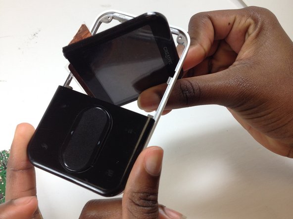

Removing the screen
  • Tilt the screen diagonally. Separate the screen and motherboard from the device frame.
  • Lift the light gray flap to detach the screen from the motherboard.
