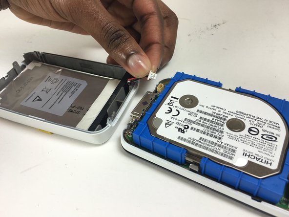

    4. Creative Zen Vision M Screen Replacement, Disconnecting the hard drive: crwdns2935265:04crwdnd2935265:01crwdnd2935265:01crwdne2935265:0
      • In the top right corner, pull the black foam square off to separate the hard drive from the screen.
      • Handle with care as the hard drive also comes off easily.

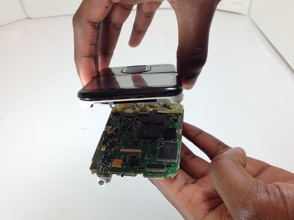

    5. Creative Zen Vision M Screen Replacement, Unscrewing from the mother board: crwdns2935265:05crwdnd2935265:01crwdnd2935265:01crwdne2935265:0
      • Unscrew the seven screws placed around the mother board.
      • You will need a one millimeter Phillips head screwdriver.
      • The screws are small, so keep them safely.

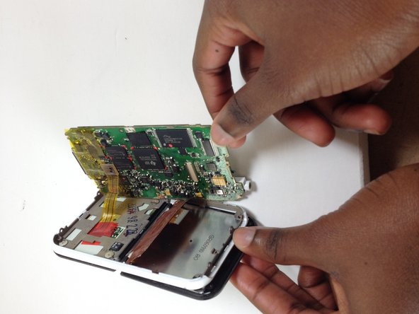

    6. Creative Zen Vision M Screen Replacement, Disconnecting the screen from the motherboard: crwdns2935265:06crwdnd2935265:01crwdnd2935265:03crwdne2935265:0 Creative Zen Vision M Screen Replacement, Disconnecting the screen from the motherboard: crwdns2935265:06crwdnd2935265:02crwdnd2935265:03crwdne2935265:0 Creative Zen Vision M Screen Replacement, Disconnecting the screen from the motherboard: crwdns2935265:06crwdnd2935265:03crwdnd2935265:03crwdne2935265:0
      • Flip your device upside down so that the motherboard will loosen.
      • Detach the connector from the motherboard.

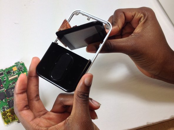

    7. Creative Zen Vision M Screen Replacement, Removing the screen: crwdns2935265:07crwdnd2935265:01crwdnd2935265:02crwdne2935265:0 Creative Zen Vision M Screen Replacement, Removing the screen: crwdns2935265:07crwdnd2935265:02crwdnd2935265:02crwdne2935265:0
      • Tilt the screen diagonally. Separate the screen and motherboard from the device frame.
      • Lift the light gray flap to detach the screen from the motherboard.

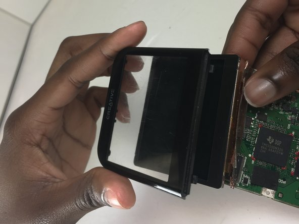

    8. Creative Zen Vision M Screen Replacement, Seperating the digital display: crwdns2935265:08crwdnd2935265:01crwdnd2935265:02crwdne2935265:0 Creative Zen Vision M Screen Replacement, Seperating the digital display: crwdns2935265:08crwdnd2935265:02crwdnd2935265:02crwdne2935265:0
      • Separate the clear screen frame from the digital display.
