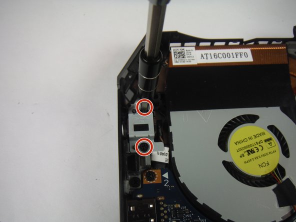

  • Remove the (2) 6 mm Phillips head screws securing the power adapter port bracket with a #1 Phillips screwdriver.
  • Lift and remove the power adapter port bracket.
