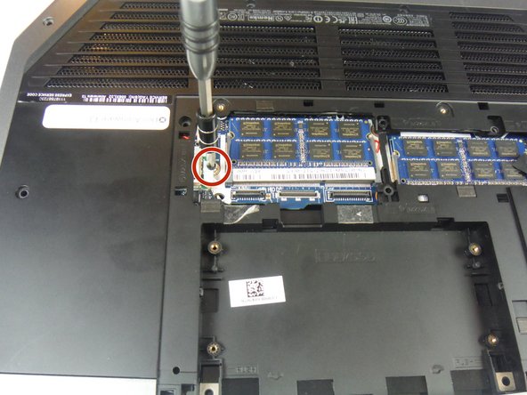

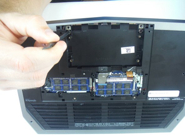

  2. Dell Alienware 13 Computer Base Replacement: crwdns2935265:02crwdnd2935265:01crwdnd2935265:01crwdne2935265:0
    • Remove (2) 5 mm Phillips head screws attaching the small access panel to the base using a Phillips # 1 screwdriver.
    • The (2) screws are attached to the base panel with retaining clips and won't completely detach from the panel.

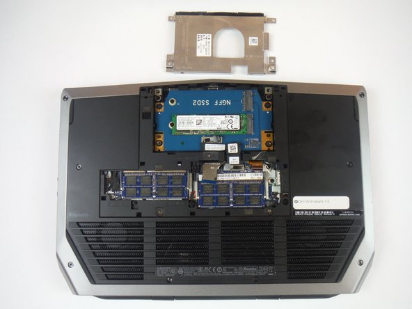

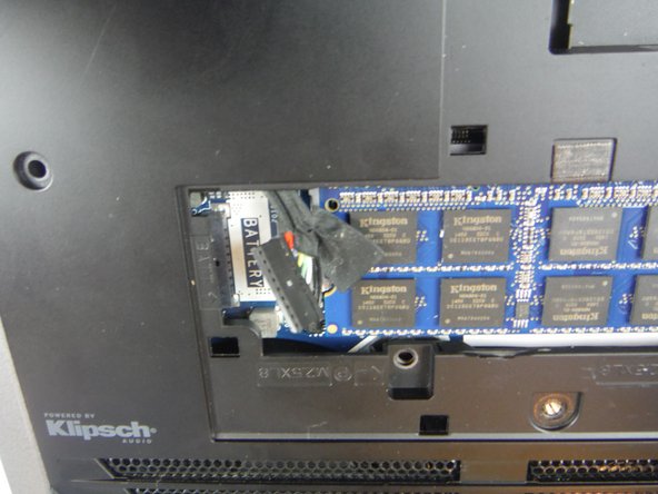

    • Disconnect the battery cable from the battery cable terminal.
  5. Dell Alienware 13 Computer Base Replacement: crwdns2935265:05crwdnd2935265:01crwdnd2935265:01crwdne2935265:0
    • Remove (4) 6 mm Phillips head screws from the solid-state metal drive bracket, using a Phillips # 1 screwdriver.
  6. Dell Alienware 13 Computer Base Replacement: crwdns2935265:06crwdnd2935265:01crwdnd2935265:02crwdne2935265:0 Dell Alienware 13 Computer Base Replacement: crwdns2935265:06crwdnd2935265:02crwdnd2935265:02crwdne2935265:0
    • Grab the pull tab to pivot the solid-state drive bracket upwards. Remove the bracket from the computer base.
  7. Dell Alienware 13 Computer Base Replacement: crwdns2935265:07crwdnd2935265:01crwdnd2935265:02crwdne2935265:0 Dell Alienware 13 Computer Base Replacement: crwdns2935265:07crwdnd2935265:02crwdnd2935265:02crwdne2935265:0

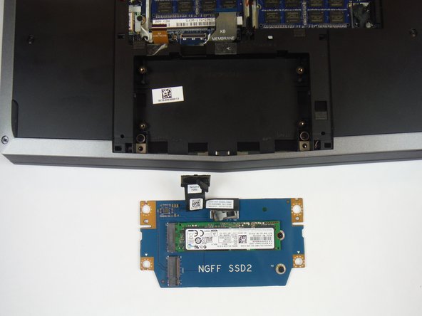

    • Using the pull tab, disconnect the black solid-state drive cable from the system board.
  8. Dell Alienware 13 Computer Base Replacement: crwdns2935265:08crwdnd2935265:01crwdnd2935265:01crwdne2935265:0
    • Remove (2) 3 mm Phillips head screws, using a Phillips # 0 screwdriver, that connect the solid-state drive assembly to the computer base.
  9. Dell Alienware 13 Computer Base Replacement: crwdns2935265:09crwdnd2935265:01crwdnd2935265:02crwdne2935265:0 Dell Alienware 13 Computer Base Replacement: crwdns2935265:09crwdnd2935265:02crwdnd2935265:02crwdne2935265:0
    • Lift up on the solid-state drive assembly to remove it from the computer base.

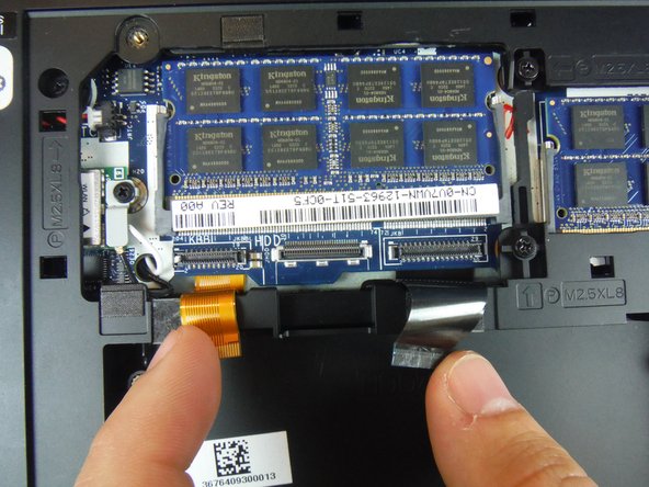

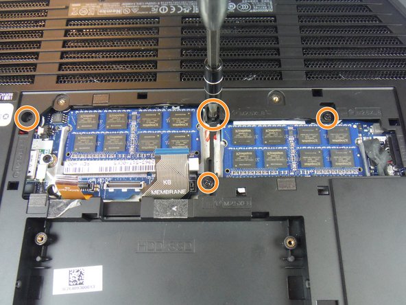

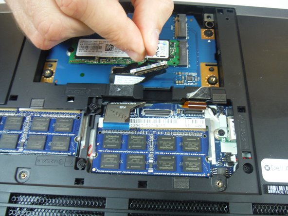

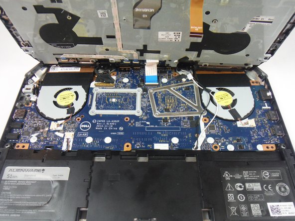

  10. Dell Alienware 13 Computer Base Replacement: crwdns2935265:010crwdnd2935265:01crwdnd2935265:02crwdne2935265:0 Dell Alienware 13 Computer Base Replacement: crwdns2935265:010crwdnd2935265:02crwdnd2935265:02crwdne2935265:0
    • Locate two cables labeled, "KB Backlight" (orange) and "KB Membrane" (black). Lift up on the latches to disconnect the cables from the system board.
    • The latches that connect the cables to the system board are very delicate. Handle with care to avoid damaging them.

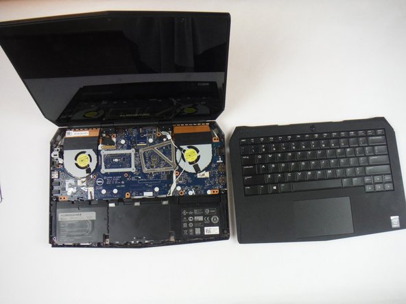

  12. Dell Alienware 13 Computer Base Replacement: crwdns2935265:012crwdnd2935265:01crwdnd2935265:02crwdne2935265:0 Dell Alienware 13 Computer Base Replacement: crwdns2935265:012crwdnd2935265:02crwdnd2935265:02crwdne2935265:0
    • Lift the computer base slightly towards you and push the release tabs on the palm-rest assembly until it pops out using a spudger.
  13. Dell Alienware 13 Computer Base Replacement: crwdns2935265:013crwdnd2935265:01crwdnd2935265:03crwdne2935265:0 Dell Alienware 13 Computer Base Replacement: crwdns2935265:013crwdnd2935265:02crwdnd2935265:03crwdne2935265:0 Dell Alienware 13 Computer Base Replacement: crwdns2935265:013crwdnd2935265:03crwdnd2935265:03crwdne2935265:0

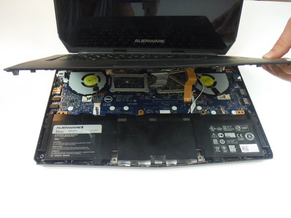

    • Turn the computer over and open the display as far as possible.
    • Using a plastic spudger, pry up along the edges of the palm-rest assembly.
    • Gently lift the palm-rest assembly.

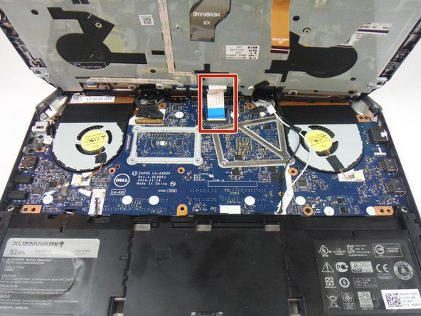

  14. Dell Alienware 13 Computer Base Replacement: crwdns2935265:014crwdnd2935265:01crwdnd2935265:03crwdne2935265:0 Dell Alienware 13 Computer Base Replacement: crwdns2935265:014crwdnd2935265:02crwdnd2935265:03crwdne2935265:0 Dell Alienware 13 Computer Base Replacement: crwdns2935265:014crwdnd2935265:03crwdnd2935265:03crwdne2935265:0

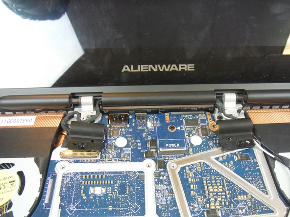

    • Lift the connector latch and disconnect the power-button board cable from the system board. Identified as a cable with a blue tab.
    • Lift the palm-rest assembly off the computer base.

    • Open the display as far as possible.

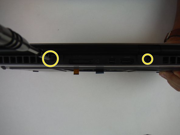

    • Remove (2) 3 mm Phillips head screws, using a Phillips head #0 screwdriver, that secure the hinge caps to the display hinges.
    • Slide and lift the hinge caps off the display hinges.

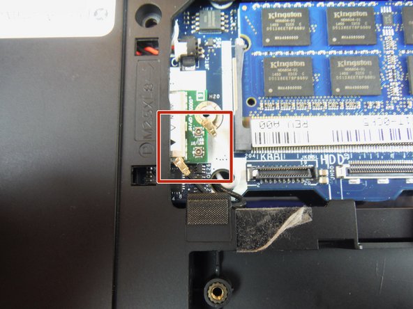

    • Remove (1) 2 mm Phillips head screw, using a Phillips head # 0 screwdriver, that secures the wireless-card bracket to the wireless card.
  17. Dell Alienware 13 Computer Base Replacement: crwdns2935265:017crwdnd2935265:01crwdnd2935265:02crwdne2935265:0 Dell Alienware 13 Computer Base Replacement: crwdns2935265:017crwdnd2935265:02crwdnd2935265:02crwdne2935265:0
    Heavy-Duty Spudger

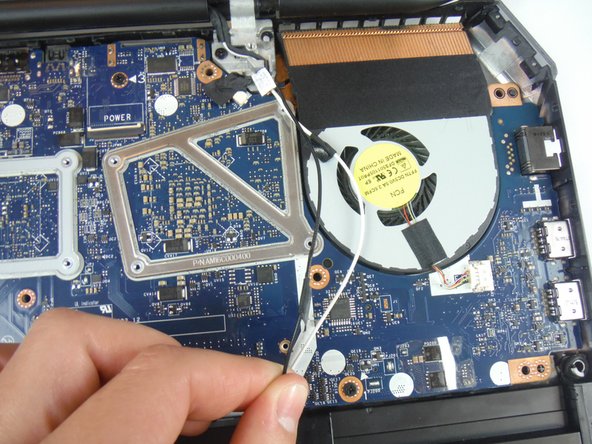

    • Disconnect the antenna cables from the wireless card using a heavy duty spudger. The wires can be removed by applying a force directed upward, away from the device.
  18. Dell Alienware 13 Computer Base Replacement: crwdns2935265:018crwdnd2935265:01crwdnd2935265:03crwdne2935265:0 Dell Alienware 13 Computer Base Replacement: crwdns2935265:018crwdnd2935265:02crwdnd2935265:03crwdne2935265:0 Dell Alienware 13 Computer Base Replacement: crwdns2935265:018crwdnd2935265:03crwdnd2935265:03crwdne2935265:0
    • Turn the computer over and open the display.

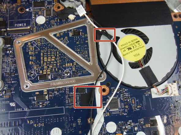

    • Peel off the adhesive tapes that secure the antenna cables to the system board.
    • Make note of how the cables are routed before removing any cables from their routing guide.

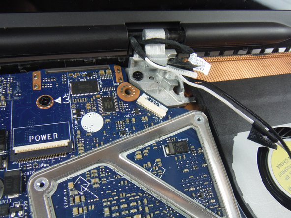

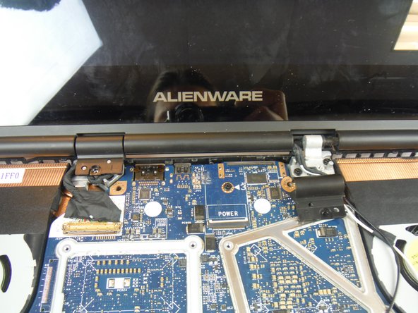

  19. Dell Alienware 13 Computer Base Replacement: crwdns2935265:019crwdnd2935265:01crwdnd2935265:03crwdne2935265:0 Dell Alienware 13 Computer Base Replacement: crwdns2935265:019crwdnd2935265:02crwdnd2935265:03crwdne2935265:0 Dell Alienware 13 Computer Base Replacement: crwdns2935265:019crwdnd2935265:03crwdnd2935265:03crwdne2935265:0

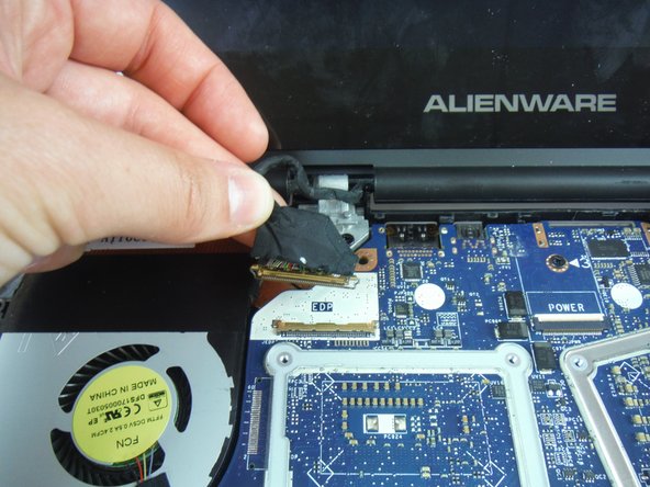

    • Lift the connector latch and disconnect the display cable from the system board.
    • Disconnect the logo-board cable from the system board.
    • Remove the antenna cables, display cable, and logo-board cable from the routing guides on the display hinges.

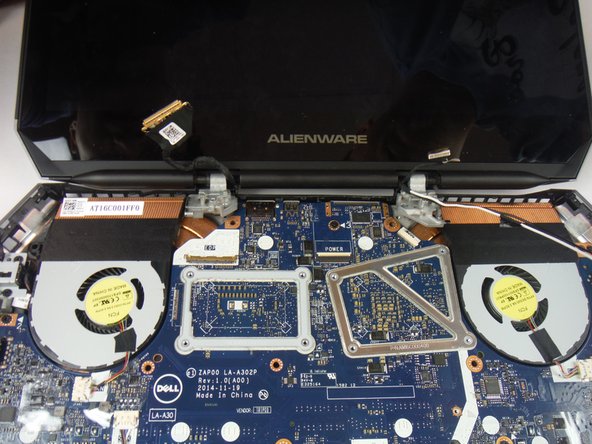

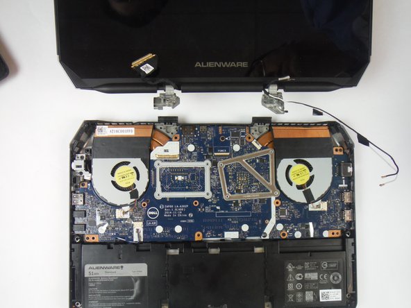

  20. Dell Alienware 13 Computer Base Replacement: crwdns2935265:020crwdnd2935265:01crwdnd2935265:03crwdne2935265:0 Dell Alienware 13 Computer Base Replacement: crwdns2935265:020crwdnd2935265:02crwdnd2935265:03crwdne2935265:0 Dell Alienware 13 Computer Base Replacement: crwdns2935265:020crwdnd2935265:03crwdnd2935265:03crwdne2935265:0
    • Remove (4) 8 mm Phillips head screws, using a Phillips # 1 screwdriver, that secure the display assembly to the computer base.
    • Lift the display assembly off the computer base.

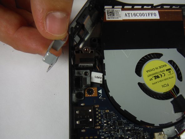

  21. Dell Alienware 13 Computer Base Replacement: crwdns2935265:021crwdnd2935265:01crwdnd2935265:02crwdne2935265:0 Dell Alienware 13 Computer Base Replacement: crwdns2935265:021crwdnd2935265:02crwdnd2935265:02crwdne2935265:0
    • Remove the (2) 6 mm Phillips head screws securing the power adapter port bracket with a #1 Phillips screwdriver.
    • Lift and remove the power adapter port bracket.
  22. Dell Alienware 13 Computer Base Replacement: crwdns2935265:022crwdnd2935265:01crwdnd2935265:01crwdne2935265:0
    • Lift up and remove the power adapter port from the computer base.
  23. Dell Alienware 13 Computer Base Replacement: crwdns2935265:023crwdnd2935265:01crwdnd2935265:02crwdne2935265:0 Dell Alienware 13 Computer Base Replacement: crwdns2935265:023crwdnd2935265:02crwdnd2935265:02crwdne2935265:0

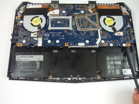

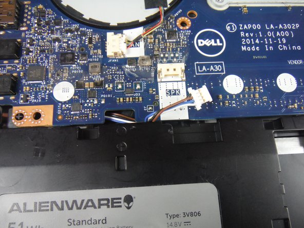

    • Disconnect the speaker cable connector from the service board.

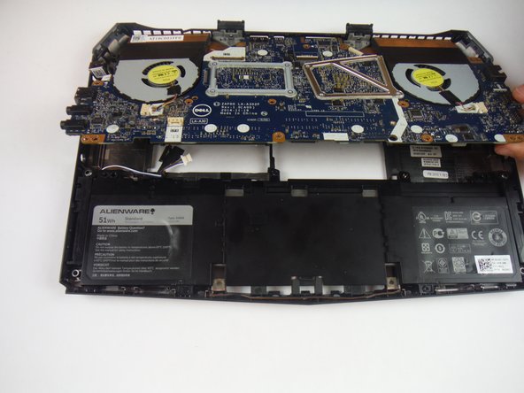

  24. Dell Alienware 13 Computer Base Replacement: crwdns2935265:024crwdnd2935265:01crwdnd2935265:03crwdne2935265:0 Dell Alienware 13 Computer Base Replacement: crwdns2935265:024crwdnd2935265:02crwdnd2935265:03crwdne2935265:0 Dell Alienware 13 Computer Base Replacement: crwdns2935265:024crwdnd2935265:03crwdnd2935265:03crwdne2935265:0
    • Remove (3) 6 mm Phillips head screws securing the service board with a #1 Phillips screwdriver.
    • Lift up on the service board assembly using a heavy duty spudger and slide the board towards the battery to remove from the base.
