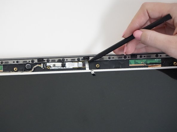

  • Use the pointed side of the black spudger to remove the metallic stickers by the circuit board of the camera above the screen.
  • Do not remove the sticker completely.
