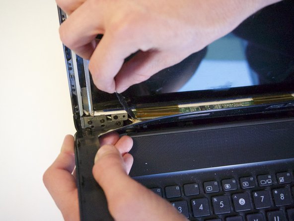

  3. ASUS U52F-BBG6 Camera Replacement: crwdns2935265:03crwdnd2935265:01crwdnd2935265:02crwdne2935265:0 ASUS U52F-BBG6 Camera Replacement: crwdns2935265:03crwdnd2935265:02crwdnd2935265:02crwdne2935265:0
    • Pull the screen frame towards you so that the seam between the frame and the bottom of the screen is opened.
    • Insert the opening tool into the seam.
    • Be careful not to scratch the screen with the opening tool.
    • Peel the metallic strip with your finger and thumb until it's fully off.
    • Place the remaining frame down on the keyboard.

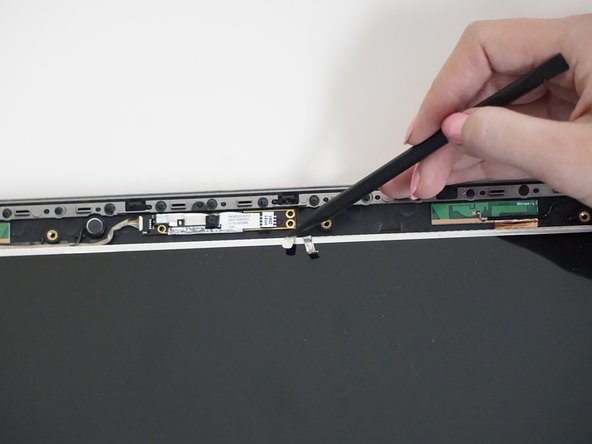

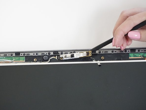

  4. ASUS U52F-BBG6 Camera Replacement: crwdns2935265:04crwdnd2935265:01crwdnd2935265:02crwdne2935265:0 ASUS U52F-BBG6 Camera Replacement: crwdns2935265:04crwdnd2935265:02crwdnd2935265:02crwdne2935265:0
    • Use the pointed side of the black spudger to remove the metallic stickers by the circuit board of the camera above the screen.
    • Do not remove the sticker completely.
  5. ASUS U52F-BBG6 Camera Replacement: crwdns2935265:05crwdnd2935265:01crwdnd2935265:02crwdne2935265:0 ASUS U52F-BBG6 Camera Replacement: crwdns2935265:05crwdnd2935265:02crwdnd2935265:02crwdne2935265:0
    • Carefully lift the camera's circuit board by using the flat side of the spudger.
    • The adherent on the camera's circuit board is very sticky.

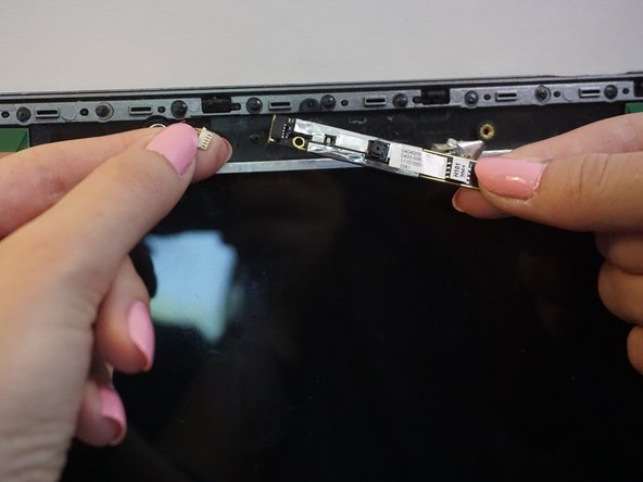

  6. ASUS U52F-BBG6 Camera Replacement: crwdns2935265:06crwdnd2935265:01crwdnd2935265:02crwdne2935265:0 ASUS U52F-BBG6 Camera Replacement: crwdns2935265:06crwdnd2935265:02crwdnd2935265:02crwdne2935265:0
    • Holding the camera's circuit board with your right hand, use your left index finger and thumb to unplug the micro white hook from the camera.
    • The micro white hook is fragile.
