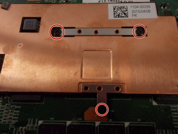

  • Locate the three 2mm screws on the bracket holding down the heat sink.
  • Using a size 0 Phillips screwdriver, remove the three 2mm screws.
