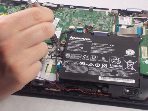

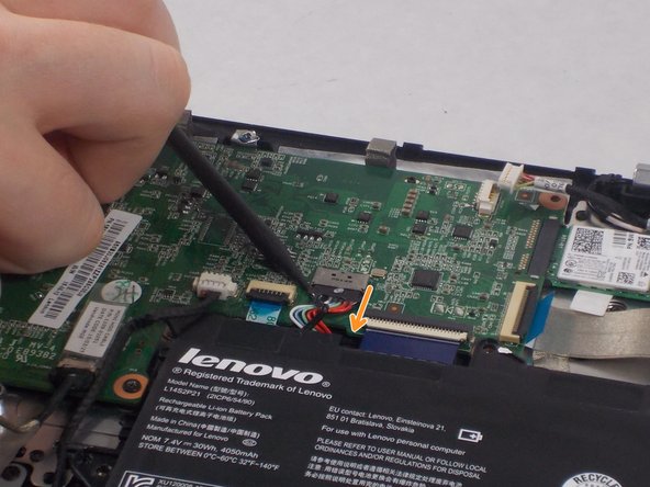

  7. Lenovo Flex 3-1120 Thermal Compound Replacement: crwdns2935265:07crwdnd2935265:01crwdnd2935265:02crwdne2935265:0 Lenovo Flex 3-1120 Thermal Compound Replacement: crwdns2935265:07crwdnd2935265:02crwdnd2935265:02crwdne2935265:0
    • Locate the multicolored power cables coming directly from the top of the battery and into the motherboard.
    • Use a spudger to slide the power cables down and away from its port on the motherboard.
  8. Lenovo Flex 3-1120 Thermal Compound Replacement: crwdns2935265:08crwdnd2935265:01crwdnd2935265:01crwdne2935265:0
    • Lift the battery out from the computer.

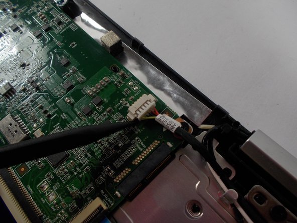

  23. Lenovo Flex 3-1120 Thermal Compound Replacement, Motherboard: crwdns2935265:023crwdnd2935265:01crwdnd2935265:02crwdne2935265:0 Lenovo Flex 3-1120 Thermal Compound Replacement, Motherboard: crwdns2935265:023crwdnd2935265:02crwdnd2935265:02crwdne2935265:0
    • Locate the power input cable on the top right corner of the motherboard.
    • Remove the power input cable by gently sliding each side of the cable out of its port. Alternate between the left and right sides of the cable until it disconnects.

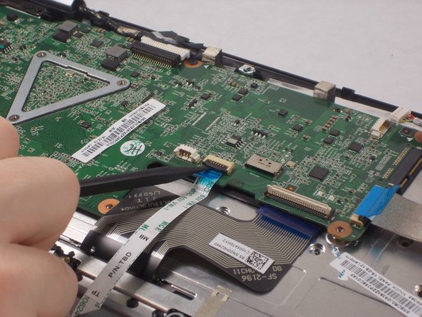

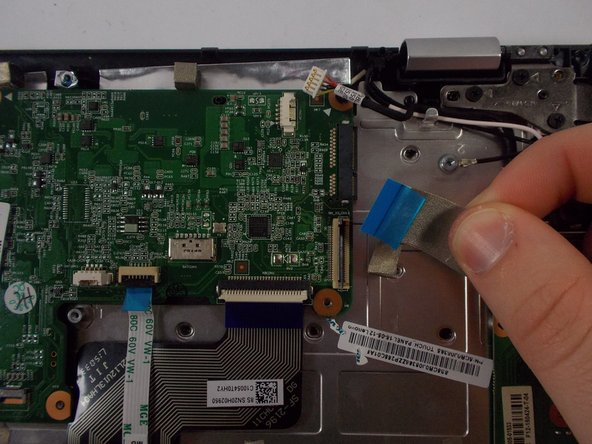

  24. Lenovo Flex 3-1120 Thermal Compound Replacement: crwdns2935265:024crwdnd2935265:01crwdnd2935265:03crwdne2935265:0 Lenovo Flex 3-1120 Thermal Compound Replacement: crwdns2935265:024crwdnd2935265:02crwdnd2935265:03crwdne2935265:0 Lenovo Flex 3-1120 Thermal Compound Replacement: crwdns2935265:024crwdnd2935265:03crwdnd2935265:03crwdne2935265:0

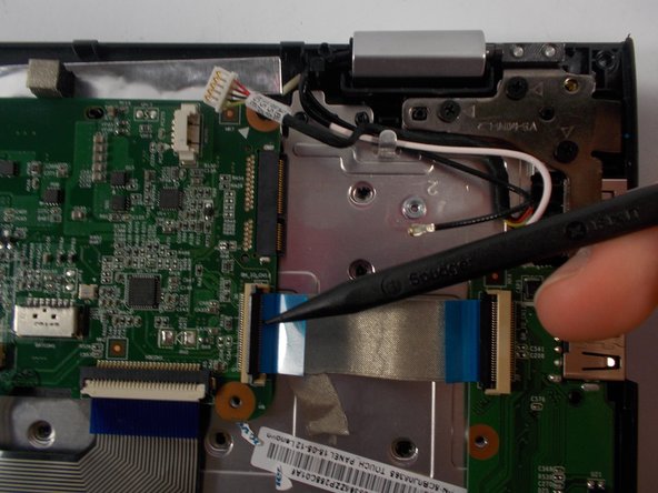

    • Locate the ribbon cable with a blue tab on it. The cable is connected to the right edge of the motherboard.
    • Lift up the black latch with the spudger.
    • Pull on the blue tab to the left to remove the cable.

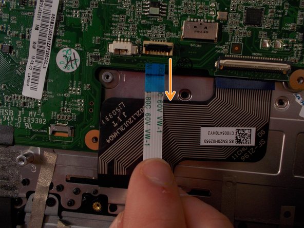

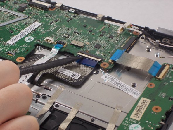

  25. Lenovo Flex 3-1120 Thermal Compound Replacement: crwdns2935265:025crwdnd2935265:01crwdnd2935265:03crwdne2935265:0 Lenovo Flex 3-1120 Thermal Compound Replacement: crwdns2935265:025crwdnd2935265:02crwdnd2935265:03crwdne2935265:0 Lenovo Flex 3-1120 Thermal Compound Replacement: crwdns2935265:025crwdnd2935265:03crwdnd2935265:03crwdne2935265:0
    • Locate the black ribbon cable on the bottom right of the motherboard.
    • Lift the white door on the end of the cable that connects to the motherboard.
    • Slide the cable down to disconnect it from the motherboard.

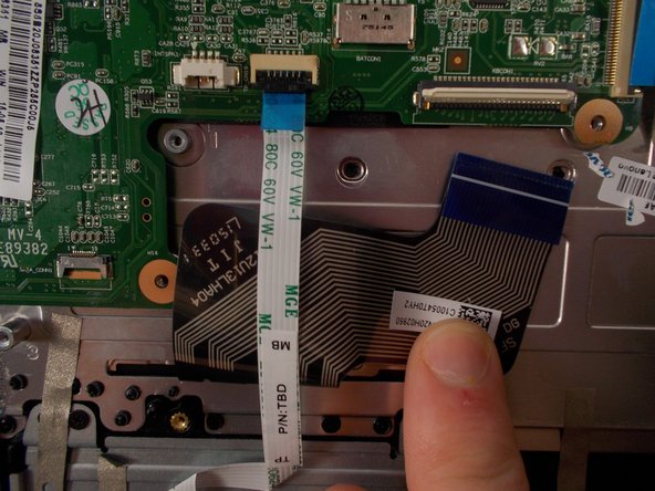

  26. Lenovo Flex 3-1120 Thermal Compound Replacement: crwdns2935265:026crwdnd2935265:01crwdnd2935265:03crwdne2935265:0 Lenovo Flex 3-1120 Thermal Compound Replacement: crwdns2935265:026crwdnd2935265:02crwdnd2935265:03crwdne2935265:0 Lenovo Flex 3-1120 Thermal Compound Replacement: crwdns2935265:026crwdnd2935265:03crwdnd2935265:03crwdne2935265:0
    • Locate the white ribbon cable with a blue tab to the left of the black ribbon cable.
    • Lift up the black latch holding the cable in to the motherboard.
    • Pull the cable out of its port on the motherboard.

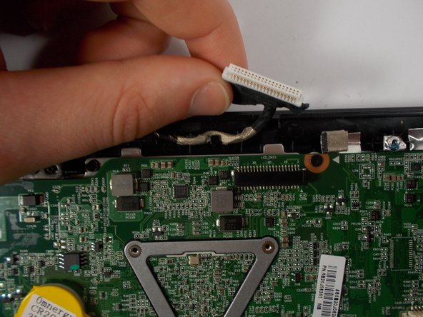

  27. Lenovo Flex 3-1120 Thermal Compound Replacement: crwdns2935265:027crwdnd2935265:01crwdnd2935265:02crwdne2935265:0 Lenovo Flex 3-1120 Thermal Compound Replacement: crwdns2935265:027crwdnd2935265:02crwdnd2935265:02crwdne2935265:0
    • Locate the white connector on the top edge of the motherboard.
    • Simply pull the wire away from the motherboard by hand to disconnect it.
    • A spudger may also be used to remove the cable, but it is not necessary.

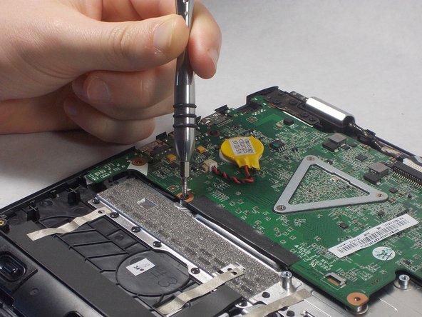

  28. Lenovo Flex 3-1120 Thermal Compound Replacement: crwdns2935265:028crwdnd2935265:01crwdnd2935265:02crwdne2935265:0 Lenovo Flex 3-1120 Thermal Compound Replacement: crwdns2935265:028crwdnd2935265:02crwdnd2935265:02crwdne2935265:0
    • Locate the three 4.5mm screws that are securing the bracket in the top left corner of the motherboard.
    • Locate the four 3.5mm screws holding the motherboard in place.
    • Remove all of the screws with a size 0 Phillips screwdriver.

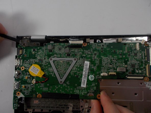

  29. Lenovo Flex 3-1120 Thermal Compound Replacement: crwdns2935265:029crwdnd2935265:01crwdnd2935265:02crwdne2935265:0 Lenovo Flex 3-1120 Thermal Compound Replacement: crwdns2935265:029crwdnd2935265:02crwdnd2935265:02crwdne2935265:0
    • Locate the metal bracket attaching the motherboard to the top-left of the computer.
    • Raise the metal bracket by prying it up and away from the motherboard.
    • Pull the motherboard away from the bracket to separate them.
    • These steps may need to be performed simultaneously in order to remove the motherboard from the bracket. The parts can easily stay stuck.
    • Do not pull the motherboard with too much force. The motherboard could be broken if handled too poorly.
  30. Lenovo Flex 3-1120 Thermal Compound Replacement: crwdns2935265:030crwdnd2935265:01crwdnd2935265:01crwdne2935265:0
    • Lift the motherboard out from the computer.

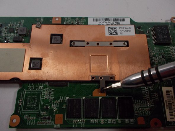

    • Locate the three 2mm screws on the bracket holding down the heat sink.
    • Using a size 0 Phillips screwdriver, remove the three 2mm screws.

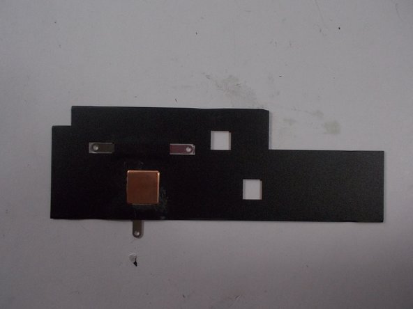

  34. Lenovo Flex 3-1120 Thermal Compound Replacement: crwdns2935265:034crwdnd2935265:01crwdnd2935265:02crwdne2935265:0 Lenovo Flex 3-1120 Thermal Compound Replacement: crwdns2935265:034crwdnd2935265:02crwdnd2935265:02crwdne2935265:0
    • Lift the copper colored heat sink away from the motherboard.
    • Place the heat sink down elsewhere with the black underside facing up.

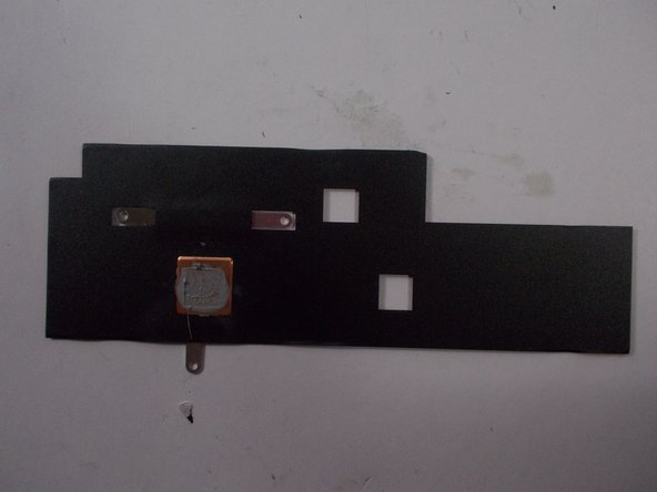

  35. Lenovo Flex 3-1120 Thermal Compound Replacement: crwdns2935265:035crwdnd2935265:01crwdnd2935265:02crwdne2935265:0 Lenovo Flex 3-1120 Thermal Compound Replacement: crwdns2935265:035crwdnd2935265:02crwdnd2935265:02crwdne2935265:0
    • Wipe the residual paste off of the heat sink using a clean cloth.

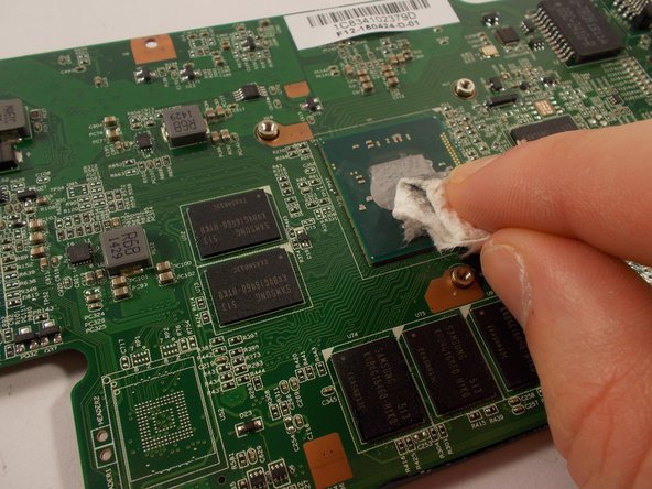

  36. Lenovo Flex 3-1120 Thermal Compound Replacement: crwdns2935265:036crwdnd2935265:01crwdnd2935265:03crwdne2935265:0 Lenovo Flex 3-1120 Thermal Compound Replacement: crwdns2935265:036crwdnd2935265:02crwdnd2935265:03crwdne2935265:0 Lenovo Flex 3-1120 Thermal Compound Replacement: crwdns2935265:036crwdnd2935265:03crwdnd2935265:03crwdne2935265:0

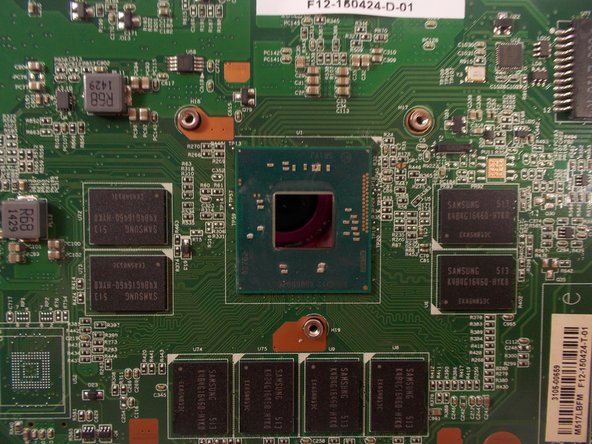

    • Wipe the residual paste off of the processor on the motherboard with a clean cloth.
  37. Lenovo Flex 3-1120 Thermal Compound Replacement: crwdns2935265:037crwdnd2935265:01crwdnd2935265:02crwdne2935265:0 Lenovo Flex 3-1120 Thermal Compound Replacement: crwdns2935265:037crwdnd2935265:02crwdnd2935265:02crwdne2935265:0

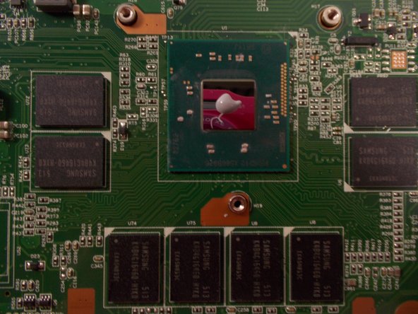

    • Apply a small drop of thermal compound to the processor.
    • You don't need to use much paste, as it will spread out when you re-attach the heat sink.
