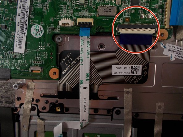

  • Locate the black ribbon cable on the bottom right of the motherboard.
  • Lift the white door on the end of the cable that connects to the motherboard.
  • Slide the cable down to disconnect it from the motherboard.
