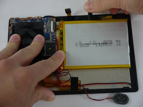

  • Using a nylon spudger, slowly work your way underneath the battery separating it from the panel beneath.
  • After the battery is separated from the panel make sure to place it face down above the tablet itself.
  • Throughout the removal process keep an eye on the battery's wires and make sure they do not break.
