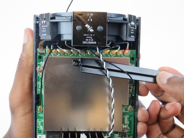

  • Make a note of each wire's position and color, so it will be easier to reconnect later.
  • Using tweezers, gently disconnect each of the 12 wire connections, attached to the top of the motherboard.
  • Be careful when removing the gold connectors as they are easily bent.
  • The connection points can be bent back if not damaged too badly.
