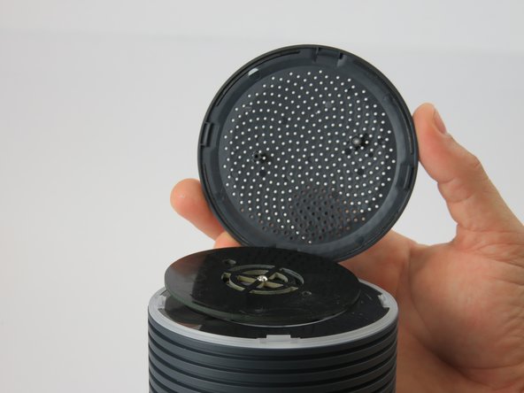

    1. OnHub OnHub Antenna Array Replacement, Speaker Grille: crwdns2935265:01crwdnd2935265:01crwdnd2935265:02crwdne2935265:0 OnHub OnHub Antenna Array Replacement, Speaker Grille: crwdns2935265:01crwdnd2935265:02crwdnd2935265:02crwdne2935265:0
      • Make sure the device is unplugged before proceeding with the disassembly.
      • While holding the base firmly using the palm of one hand, remove the cowl (cover) by turning the cowl counterclockwise until a snap is heard. Once disengaged, pull upwards.

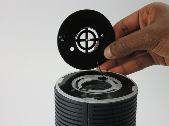

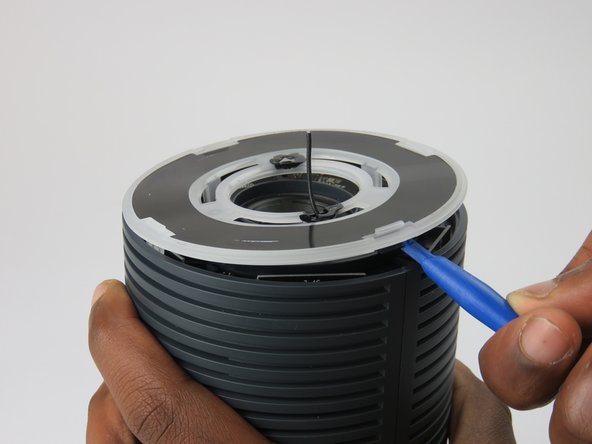

    2. OnHub OnHub Antenna Array Replacement: crwdns2935265:02crwdnd2935265:01crwdnd2935265:01crwdne2935265:0
      • Place the plastic opening tool under the speaker grille, and just above the light ring.
      • Move the plastic opening tool around the groove while applying upward force to pry loose the 4 clips holding the grille in place.
    3. OnHub OnHub Antenna Array Replacement: crwdns2935265:03crwdnd2935265:01crwdnd2935265:02crwdne2935265:0 OnHub OnHub Antenna Array Replacement: crwdns2935265:03crwdnd2935265:02crwdnd2935265:02crwdne2935265:0
      • Using a metal spudger, carefully remove the congestion-sensor antenna by undoing the two clips.
      • There is a delicate wire connection to the antenna that is easily broken if not careful.

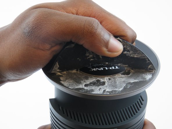

      • On the bottom of the OnHub is two screws holding the casing to the base.
      • To access these screws, you must remove the rubber pad that is glued to the base.
      • To remove the pad, slide a metal spudger under the edge of the pad. Pry the pad away from the base, removing the glue.
      • Once the pad is pulled up enough to grab, peel it the rest of the way exposing the screws.
      • The rubber pad is thin and fragile; be careful not to tear when removing.

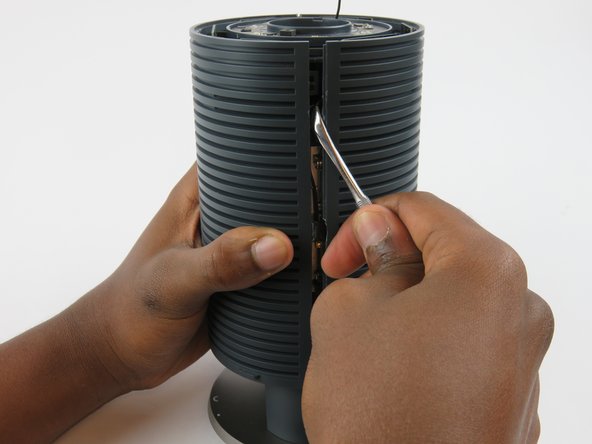

    5. OnHub OnHub Antenna Array Replacement: crwdns2935265:09crwdnd2935265:01crwdnd2935265:02crwdne2935265:0 OnHub OnHub Antenna Array Replacement: crwdns2935265:09crwdnd2935265:02crwdnd2935265:02crwdne2935265:0
      • Once the two screws are removed from the base, it is time to split the casing apart.
      • It is okay if a couple clips break. It will still hold together with a few remaining.
      • Wedge a spudger between the two casing halves, and pry the clips apart starting from the top
      • There are three hooking style clips in total.
    6. OnHub OnHub Antenna Array Replacement: crwdns2935265:010crwdnd2935265:01crwdnd2935265:01crwdne2935265:0
      • Once unclipped, you can slide the two casing halves apart, and remove the casing.

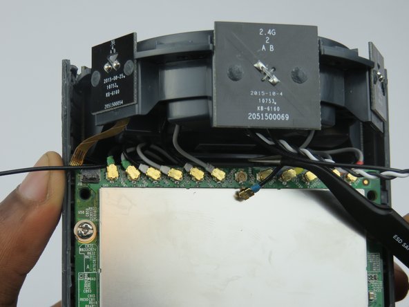

    1. OnHub OnHub Antenna Array Replacement, OnHub Antenna Array: crwdns2935265:013crwdnd2935265:01crwdnd2935265:01crwdne2935265:0
      • There is a black, horizontal brace covering 12 wire connections.
      • Remove the brace, held by two screws
    2. OnHub OnHub Antenna Array Replacement: crwdns2935265:014crwdnd2935265:01crwdnd2935265:02crwdne2935265:0 OnHub OnHub Antenna Array Replacement: crwdns2935265:014crwdnd2935265:02crwdnd2935265:02crwdne2935265:0
      • Make a note of each wire's position and color, so it will be easier to reconnect later.
      • Using tweezers, gently disconnect each of the 12 wire connections, attached to the top of the motherboard.
      • Be careful when removing the gold connectors as they are easily bent.
      • The connection points can be bent back if not damaged too badly.

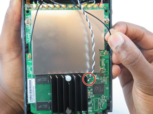

    3. OnHub OnHub Antenna Array Replacement: crwdns2935265:015crwdnd2935265:01crwdnd2935265:01crwdne2935265:0
      • Make sure to carefully pull the tape style wire furthest to the left that is held by glue.

That’s not a “tape-style wire”, that’s a ZIF flex cable! (ZIF is short for Zero Insertion Force)
To unplug that flex cable (which connects the LEDs to the main board) flip the little black bit at the other side of the connector up, then pull out the cable.
