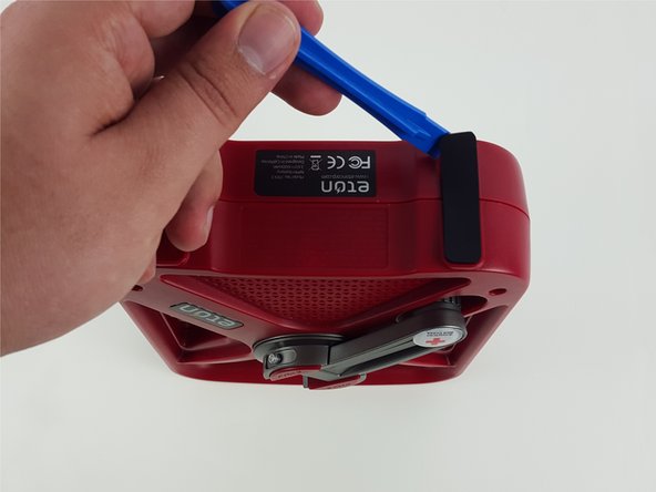

  • On the bottom of the device are two rubber feet. Using the blue plastic opening tool, pry them up and pull straight off.
  • It’s best to place these on their non-sticky side while you work, as you’ll want them to keep as much tackiness as possible for reassembly.
