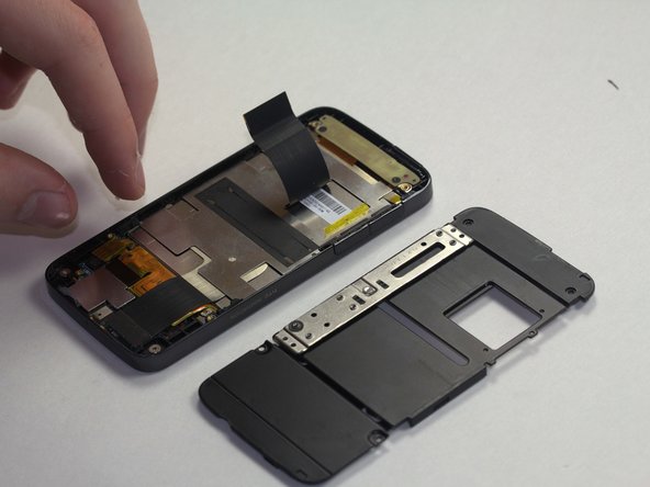

  • Remove the connected circuit board components behind the phone's navigation buttons.
  • Remove the four circuit board screws using the PH #0 screwdriver
