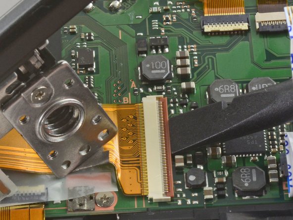

  • To remove the ribbon cable, flip back the orange lock on the large ZIF connector with the flat end of a spudger.
  • If the ribbon cable does not pop out on its own, use tweezers to pull it out of the connector.
