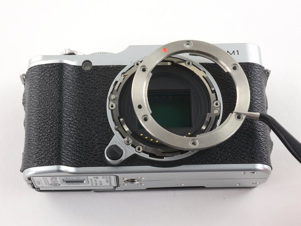

      • Remove the six 6.5 mm Phillips screws from the lens mount.
      • Use tweezers to remove the top metal ring and the thin metal ring below it .

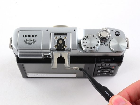

      • Use tweezers to slide the metal shield straight out of the external flash mount.

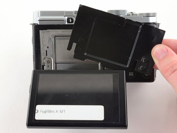

    8. Fujifilm X-M1 Disassembly: crwdns2935265:08crwdnd2935265:01crwdnd2935265:01crwdne2935265:0
      • Extend the LCD.
      • Remove the two black 4.3 mm Phillips screws from the back case.
    9. Fujifilm X-M1 Disassembly: crwdns2935265:09crwdnd2935265:01crwdnd2935265:02crwdne2935265:0 Fujifilm X-M1 Disassembly: crwdns2935265:09crwdnd2935265:02crwdnd2935265:02crwdne2935265:0
      • Use two fingers to peel back and remove the black plastic cover from behind the LCD.

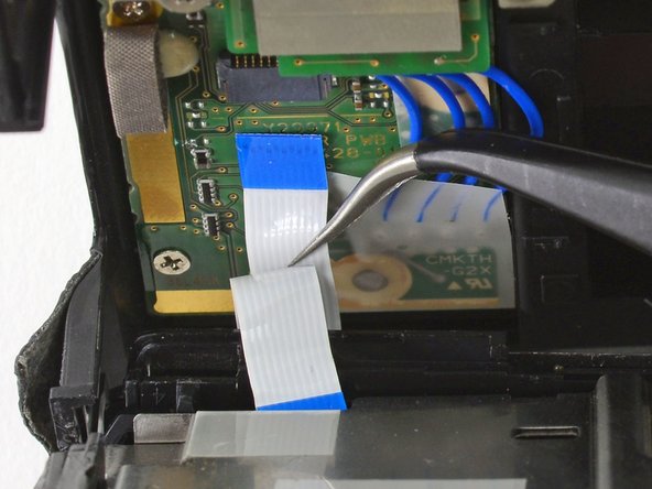

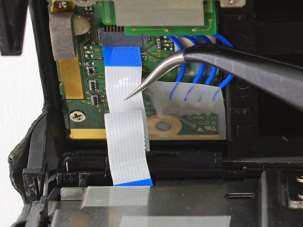

      • Slowly pull the back frame away from the camera.
      • Do not attempt to remove the frame, as it is attached to the camera by a ribbon cable.
      • Use tweezers to pull the white and blue ribbon cable out of the connector.

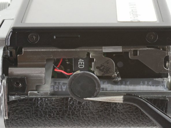

    13. Fujifilm X-M1 Disassembly: crwdns2935265:013crwdnd2935265:01crwdnd2935265:02crwdne2935265:0 Fujifilm X-M1 Disassembly: crwdns2935265:013crwdnd2935265:02crwdnd2935265:02crwdne2935265:0
      • Use tweezers to unhook the speaker near the left handgrip.

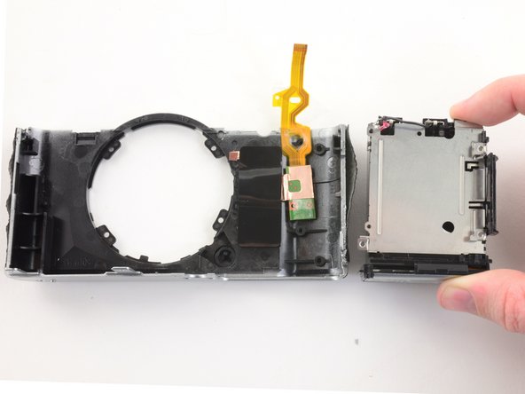

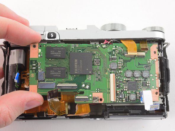

      • Slowly lift the metal frame away from the motherboard.
      • Do not attempt to remove the frame, as it is attached to the motherboard by a large ribbon cable.
      • Use tweezers to remove the plastic covering the motherboard.

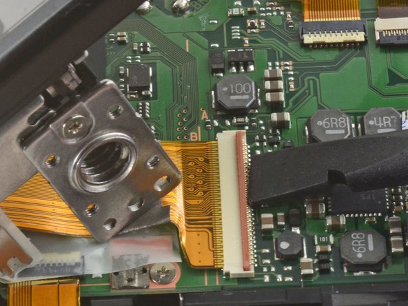

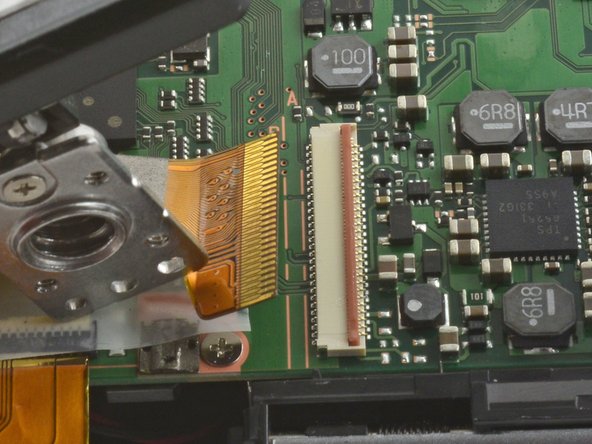

    15. Fujifilm X-M1 Disassembly: crwdns2935265:015crwdnd2935265:01crwdnd2935265:03crwdne2935265:0 Fujifilm X-M1 Disassembly: crwdns2935265:015crwdnd2935265:02crwdnd2935265:03crwdne2935265:0 Fujifilm X-M1 Disassembly: crwdns2935265:015crwdnd2935265:03crwdnd2935265:03crwdne2935265:0

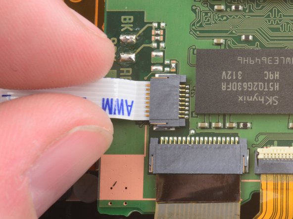

      • To remove the ribbon cable, flip back the orange lock on the large ZIF connector with the flat end of a spudger.
      • If the ribbon cable does not pop out on its own, use tweezers to pull it out of the connector.

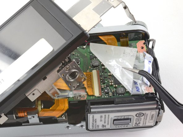

    16. Fujifilm X-M1 Disassembly: crwdns2935265:016crwdnd2935265:01crwdnd2935265:01crwdne2935265:0
      • Use tweezers to remove the three pieces of tape covering the components of the motherboard.

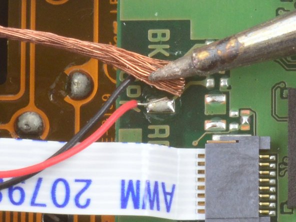

    17. Fujifilm X-M1 Disassembly: crwdns2935265:017crwdnd2935265:01crwdnd2935265:03crwdne2935265:0 Fujifilm X-M1 Disassembly: crwdns2935265:017crwdnd2935265:02crwdnd2935265:03crwdne2935265:0 Fujifilm X-M1 Disassembly: crwdns2935265:017crwdnd2935265:03crwdnd2935265:03crwdne2935265:0

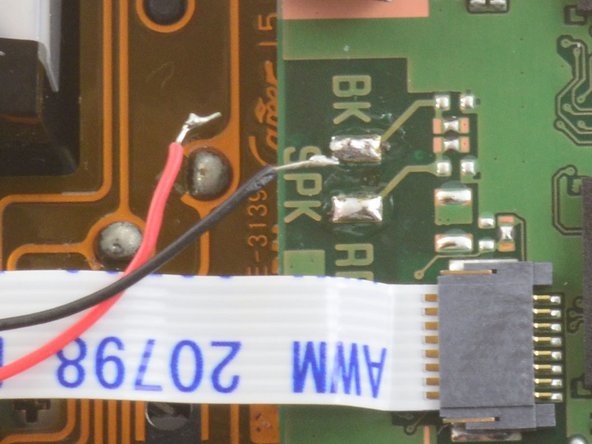

      • Desolder the three pairs of red and black wires attached to the mother board.
      • Learn more about desoldering wires here.

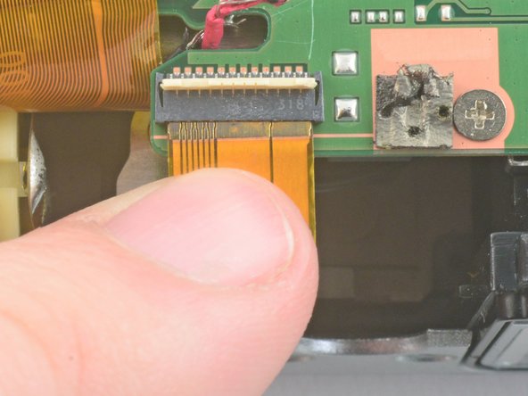

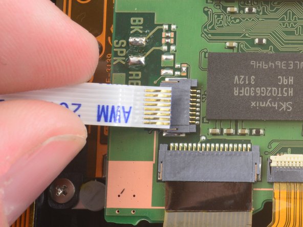

      • Use two fingers to remove the two ribbon cables in the bottom left corner of the motherboard.
    20. Fujifilm X-M1 Disassembly: crwdns2935265:020crwdnd2935265:01crwdnd2935265:03crwdne2935265:0 Fujifilm X-M1 Disassembly: crwdns2935265:020crwdnd2935265:02crwdnd2935265:03crwdne2935265:0 Fujifilm X-M1 Disassembly: crwdns2935265:020crwdnd2935265:03crwdnd2935265:03crwdne2935265:0

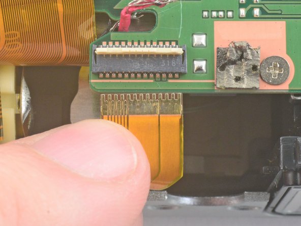

      • Use the flat end of a spudger to unlock the four indicated ZIF connectors.
      • Use two fingers to pull the ribbon cables out of the connectors.

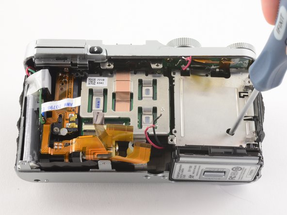

      • Insert a Phillips #00 screwdriver through the hole beneath the black tape to remove a 4.8 mm screw.
      • Insert a Phillips #00 screwdriver through the white tamper evident sticker to remove a second 4.8 mm screw.

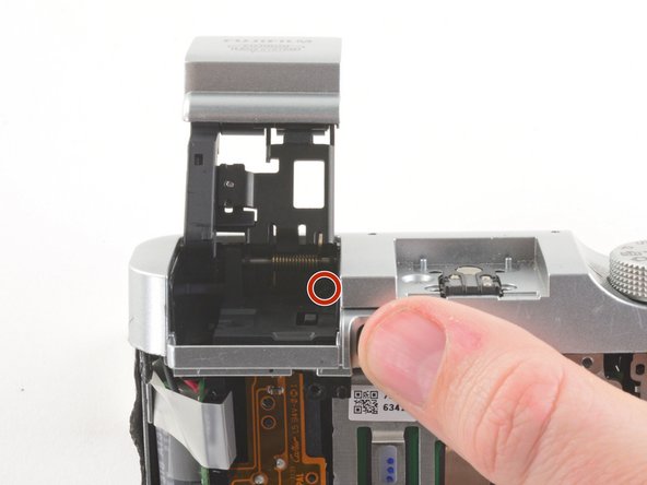

      • Press the flash button to release the flash assembly.
      • Remove the 3.4 mm Phillips screw in the back of the flash compartment.

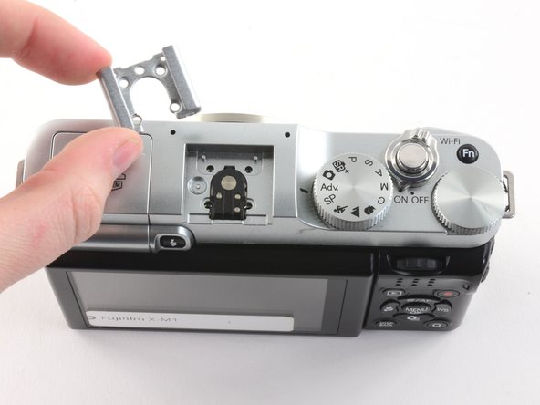

    25. Fujifilm X-M1 Disassembly: crwdns2935265:025crwdnd2935265:01crwdnd2935265:02crwdne2935265:0 Fujifilm X-M1 Disassembly: crwdns2935265:025crwdnd2935265:02crwdnd2935265:02crwdne2935265:0

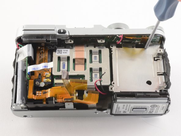

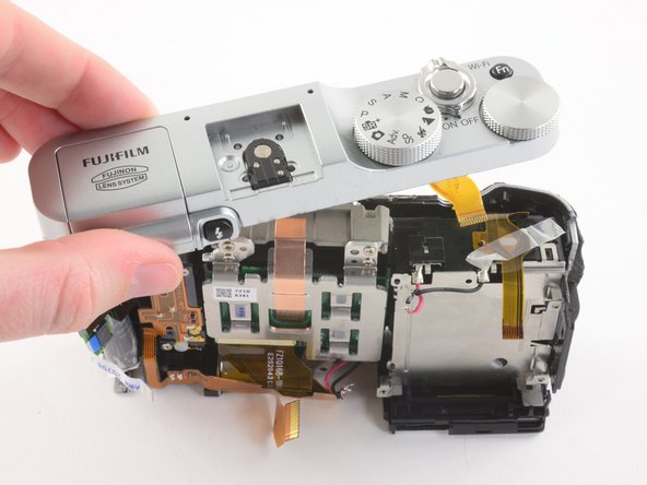

      • Remove the top plate.
    26. Fujifilm X-M1 Disassembly: crwdns2935265:026crwdnd2935265:01crwdnd2935265:01crwdne2935265:0

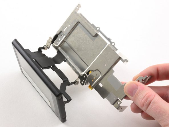

    28. Fujifilm X-M1 Disassembly: crwdns2935265:028crwdnd2935265:01crwdnd2935265:02crwdne2935265:0 Fujifilm X-M1 Disassembly: crwdns2935265:028crwdnd2935265:02crwdnd2935265:02crwdne2935265:0

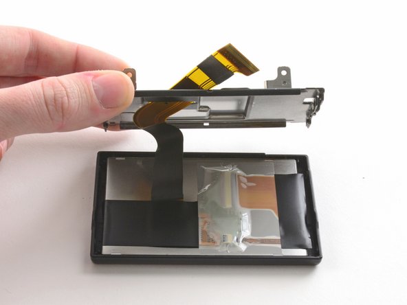

      • Remove the four 2.6 mm Phillips screws from the LCD hinges.
      • Tilt the LCD away from the metal frame.
      • Do not attempt to remove the LCD, as it is attached to the metal frame by a ribbon cable.

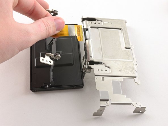

    29. Fujifilm X-M1 Disassembly: crwdns2935265:029crwdnd2935265:01crwdnd2935265:02crwdne2935265:0 Fujifilm X-M1 Disassembly: crwdns2935265:029crwdnd2935265:02crwdnd2935265:02crwdne2935265:0

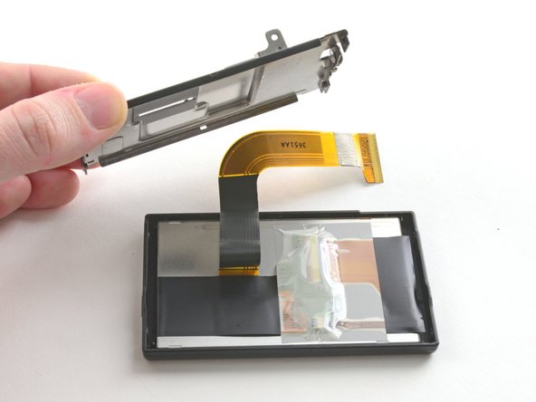

      • Use two fingers to pull the ribbon through the hole in the metal frame.
      • Remove the LCD from the metal frame.

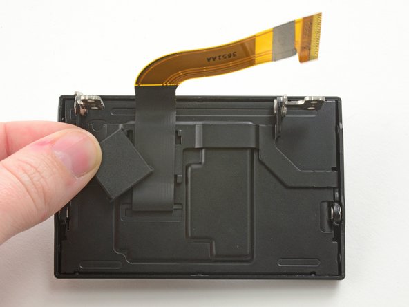

      • Use the pointed end of a spudger to remove the ribbon cover on the back of the LCD.
    31. Fujifilm X-M1 Disassembly: crwdns2935265:031crwdnd2935265:01crwdnd2935265:02crwdne2935265:0 Fujifilm X-M1 Disassembly: crwdns2935265:031crwdnd2935265:02crwdnd2935265:02crwdne2935265:0

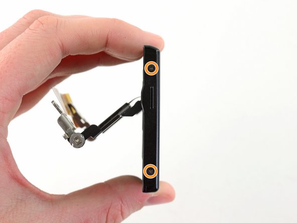

      • Remove the two 2.6 mm Phillips screws from the right hand side of the LCD screen.
      • Remove the two 2.6 mm Phillips screws from the left hand side of the LCD screen.

what about the top plate??? no one apparently knows how to remove the rotary switches from the upper assembly. Still looking for someone to show how those things are assembled
