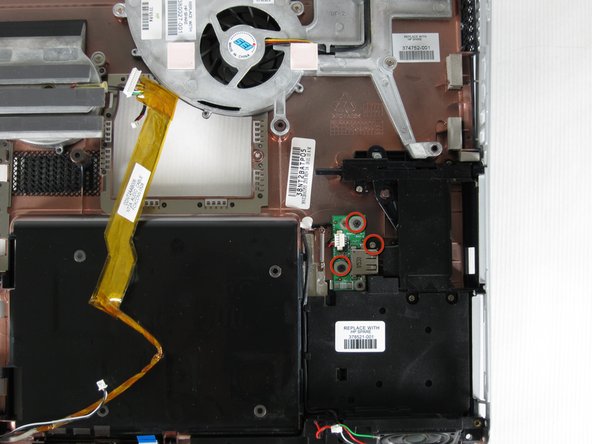

  • Unscrew the two 4mm and one 2mm Phillips screws from the USB board.
