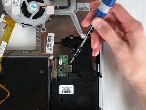

  32. HP Pavilion zd8000 Right Speaker Replacement, USB Module: crwdns2935265:032crwdnd2935265:01crwdnd2935265:02crwdne2935265:0 HP Pavilion zd8000 Right Speaker Replacement, USB Module: crwdns2935265:032crwdnd2935265:02crwdnd2935265:02crwdne2935265:0
    • Rotate the laptop 90 degrees counter-clockwise
    • Locate the USB Module
    • Grip the yellow cable cover and pull it to the right to release it.
  33. HP Pavilion zd8000 Right Speaker Replacement: crwdns2935265:033crwdnd2935265:01crwdnd2935265:02crwdne2935265:0 HP Pavilion zd8000 Right Speaker Replacement: crwdns2935265:033crwdnd2935265:02crwdnd2935265:02crwdne2935265:0
    • Unscrew the 6mm Philips screw connecting the USB module to the fan.
  34. HP Pavilion zd8000 Right Speaker Replacement: crwdns2935265:034crwdnd2935265:01crwdnd2935265:01crwdne2935265:0
    • Pull the module to the right and lift it out to release it.

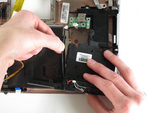

    • Using tweezers, remove the digital drive board cable - the cable set on the right with black, red, green, and white wires.

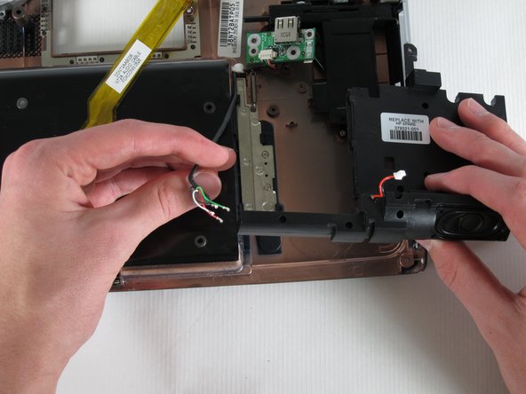

    • Using tweezers, remove the the rigth speaker cable - the cable set on the left with red and black wires - by pulling the white connector towards you.
  38. HP Pavilion zd8000 Right Speaker Replacement: crwdns2935265:038crwdnd2935265:01crwdnd2935265:02crwdne2935265:0 HP Pavilion zd8000 Right Speaker Replacement: crwdns2935265:038crwdnd2935265:02crwdnd2935265:02crwdne2935265:0
    • Using tweezers, remove the left speaker cable by pulling the white connector towards you.

  49. HP Pavilion zd8000 Right Speaker Replacement: crwdns2935265:049crwdnd2935265:01crwdnd2935265:02crwdne2935265:0 HP Pavilion zd8000 Right Speaker Replacement: crwdns2935265:049crwdnd2935265:02crwdnd2935265:02crwdne2935265:0
    • Turn the computer 90 degrees counter-clockwise and clear all cables off of the motherboard.
    • Push in the grey button to the left of the PC card as far as possible.

  52. HP Pavilion zd8000 Right Speaker Replacement, Right Speaker: crwdns2935265:052crwdnd2935265:01crwdnd2935265:02crwdne2935265:0 HP Pavilion zd8000 Right Speaker Replacement, Right Speaker: crwdns2935265:052crwdnd2935265:02crwdnd2935265:02crwdne2935265:0
    • Unscrew the two 4mm and one 2mm Phillips screws from the USB board.
  53. HP Pavilion zd8000 Right Speaker Replacement: crwdns2935265:053crwdnd2935265:01crwdnd2935265:01crwdne2935265:0
    • Move the USB board out of the way and raise the right speaker unit up two inches.
  54. HP Pavilion zd8000 Right Speaker Replacement: crwdns2935265:054crwdnd2935265:01crwdnd2935265:03crwdne2935265:0 HP Pavilion zd8000 Right Speaker Replacement: crwdns2935265:054crwdnd2935265:02crwdnd2935265:03crwdne2935265:0 HP Pavilion zd8000 Right Speaker Replacement: crwdns2935265:054crwdnd2935265:03crwdnd2935265:03crwdne2935265:0
    • Pull out the black cable running along the left side of the right speaker unit to remove it.
