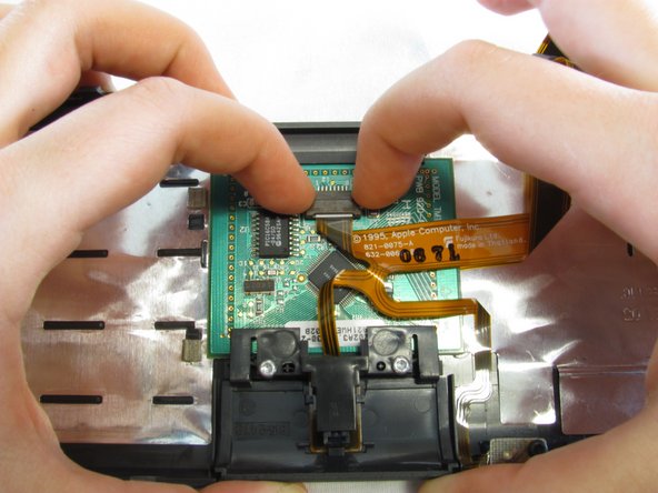

PowerBook 3400 M3553 Track Pad Replacement

  • Push the buttons on the side of the ribbon cable port on the track pad to release the ribbon cable. Then gently pull the ribbon cable free.
