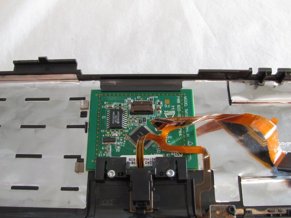

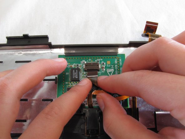

    1. PowerBook 3400 M3553 Track Pad Replacement, Track Pad: crwdns2935265:010crwdnd2935265:01crwdnd2935265:03crwdne2935265:0 PowerBook 3400 M3553 Track Pad Replacement, Track Pad: crwdns2935265:010crwdnd2935265:02crwdnd2935265:03crwdne2935265:0 PowerBook 3400 M3553 Track Pad Replacement, Track Pad: crwdns2935265:010crwdnd2935265:03crwdnd2935265:03crwdne2935265:0
      • Push the buttons on the side of the ribbon cable port on the track pad to release the ribbon cable. Then gently pull the ribbon cable free.
    2. PowerBook 3400 M3553 Track Pad Replacement: crwdns2935265:011crwdnd2935265:01crwdnd2935265:01crwdne2935265:0
      • Remove two T8 7mm long torx screws from the bottom of the track pad panel.
    3. PowerBook 3400 M3553 Track Pad Replacement: crwdns2935265:012crwdnd2935265:01crwdnd2935265:01crwdne2935265:0
      • Slide the track pad button off of the track pad panel.
    4. PowerBook 3400 M3553 Track Pad Replacement: crwdns2935265:013crwdnd2935265:01crwdnd2935265:01crwdne2935265:0
      • Remove the track pad by gently lifting up.
