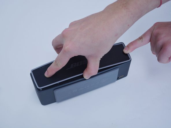

  • To replace the speaker guard, make sure the rubber insert is in place on the back of the mesh guard.
  • Insert one end of the speaker guard into the frame. Then gently fit the other end of the speaker guard into the frame.
  • You will have to fit the tabs on one end into the device first, and then slightly bend the guard into the other side.
  • Press firmly on the speaker guard ensuring that it is properly installed.
