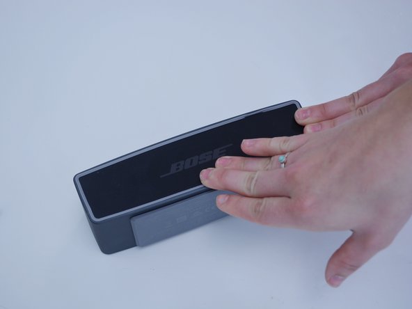

    • Two mesh tabs hold the speaker guard in place on either end.
    • Use the plastic opening tool to peel away the rubber insert.
    • Use the metal spudger to lift one of the tabs away from the device.
  2. Bose Soundlink Mini II Speaker Guard Replacement: crwdns2935265:02crwdnd2935265:01crwdnd2935265:02crwdne2935265:0 Bose Soundlink Mini II Speaker Guard Replacement: crwdns2935265:02crwdnd2935265:02crwdnd2935265:02crwdne2935265:0
    • Carefully peel the mesh speaker guard away from the device.
  3. Bose Soundlink Mini II Speaker Guard Replacement: crwdns2935265:03crwdnd2935265:01crwdnd2935265:01crwdne2935265:0
    • Remove the mesh tabs from the other side of the device.
  4. Bose Soundlink Mini II Speaker Guard Replacement: crwdns2935265:04crwdnd2935265:01crwdnd2935265:02crwdne2935265:0 Bose Soundlink Mini II Speaker Guard Replacement: crwdns2935265:04crwdnd2935265:02crwdnd2935265:02crwdne2935265:0
    • To replace the speaker guard, make sure the rubber insert is in place on the back of the mesh guard.
    • Insert one end of the speaker guard into the frame. Then gently fit the other end of the speaker guard into the frame.
    • You will have to fit the tabs on one end into the device first, and then slightly bend the guard into the other side.
    • Press firmly on the speaker guard ensuring that it is properly installed.
