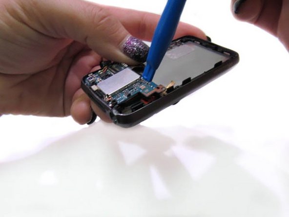

  • Using a small plastic prying tool, slip the end under the device circuit board and slowly lift it.
  • Once the circuit board is lifted, carefully remove the chip with tweezers.
  • The circuit board will still be connected to the device by a wire.
