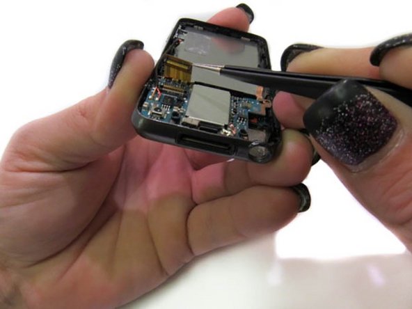

  3. Sony Walkman NWZ-E438 Device Circuit Board Replacement, Circuit Board: crwdns2935265:03crwdnd2935265:01crwdnd2935265:03crwdne2935265:0 Sony Walkman NWZ-E438 Device Circuit Board Replacement, Circuit Board: crwdns2935265:03crwdnd2935265:02crwdnd2935265:03crwdne2935265:0 Sony Walkman NWZ-E438 Device Circuit Board Replacement, Circuit Board: crwdns2935265:03crwdnd2935265:03crwdnd2935265:03crwdne2935265:0
    • First, you must remove the black tape on the circuit board.
    • Next, pull up on the red and gold band until it detaches from the chip.

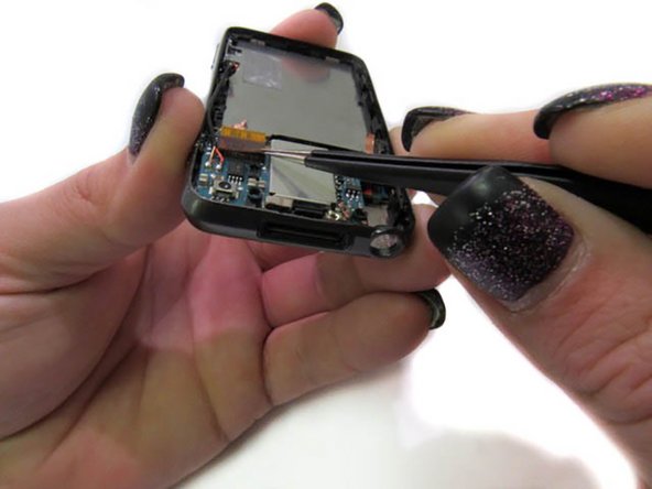

  4. Sony Walkman NWZ-E438 Device Circuit Board Replacement: crwdns2935265:04crwdnd2935265:01crwdnd2935265:02crwdne2935265:0 Sony Walkman NWZ-E438 Device Circuit Board Replacement: crwdns2935265:04crwdnd2935265:02crwdnd2935265:02crwdne2935265:0
    • Using a small plastic prying tool, slip the end under the device circuit board and slowly lift it.
    • Once the circuit board is lifted, carefully remove the chip with tweezers.
    • The circuit board will still be connected to the device by a wire.
