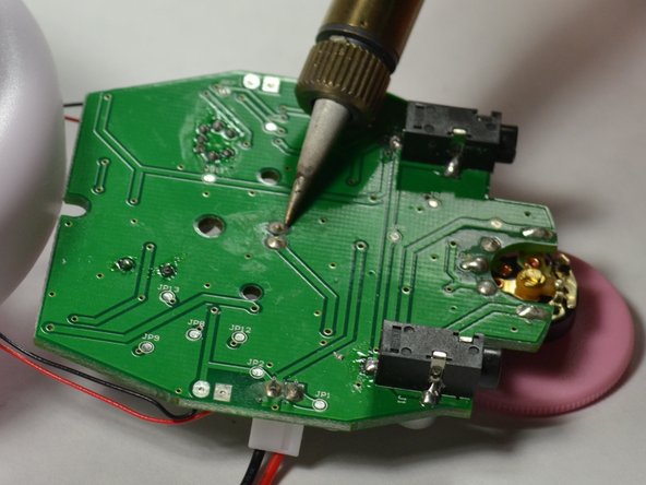

  • Desoldering
  • If steam is created when the soldering iron is touched to a wet sponge then the soldering iron is hot enough.
  • Use the soldering iron and soldering vacuum to unsolder the indicator light leads.
  • Plastic spacer holding indicator light may burn.
