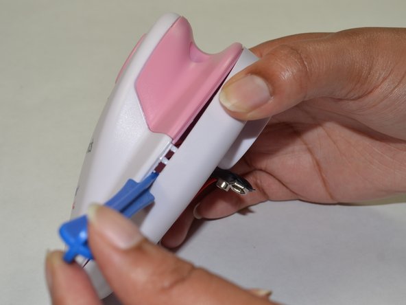

  4. Jumper Angelsounds JPD-100S Indicator Light Replacement: crwdns2935265:04crwdnd2935265:01crwdnd2935265:02crwdne2935265:0 Jumper Angelsounds JPD-100S Indicator Light Replacement: crwdns2935265:04crwdnd2935265:02crwdnd2935265:02crwdne2935265:0
    • Begin prying open the device.
    • Insert a plastic opening tool into the side groove about 2cm from the pink plastic component and pry open one side of the device.
    • Once the side is separated, leave the opening tool inside to prevent the two sides from closing.
  5. Jumper Angelsounds JPD-100S Indicator Light Replacement: crwdns2935265:05crwdnd2935265:01crwdnd2935265:02crwdne2935265:0 Jumper Angelsounds JPD-100S Indicator Light Replacement: crwdns2935265:05crwdnd2935265:02crwdnd2935265:02crwdne2935265:0
    • Insert another plastic opening tool into the groove opposite to the side of the tool already inserted.
    • Create separation on that side until the white plastic component comes off entirely.
    • Place the white plastic component in a secure place.

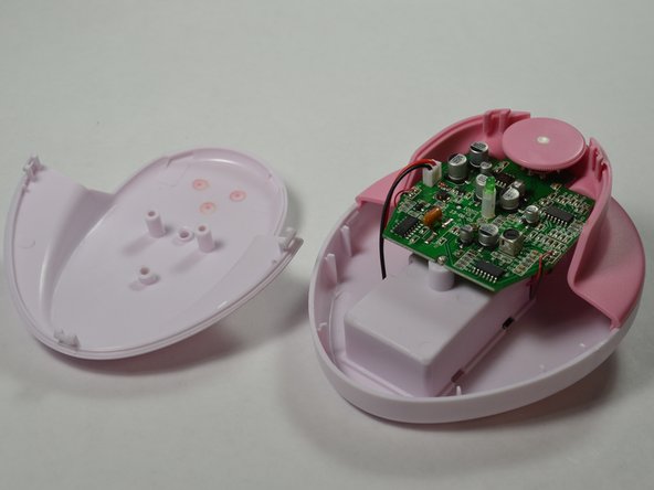

  6. Jumper Angelsounds JPD-100S Indicator Light Replacement: crwdns2935265:06crwdnd2935265:01crwdnd2935265:01crwdne2935265:0
    • With your hand, remove the pink component.
  7. Jumper Angelsounds JPD-100S Indicator Light Replacement: crwdns2935265:07crwdnd2935265:01crwdnd2935265:01crwdne2935265:0
    • Remove the 7mm Phillips #1 screw in the middle of the motherboard.

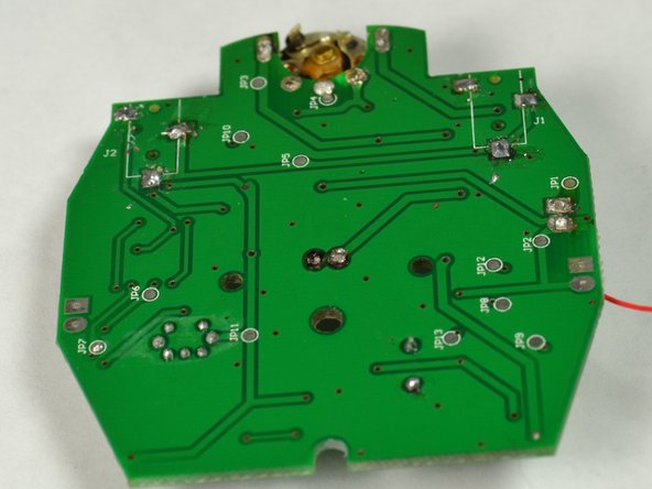

  8. Jumper Angelsounds JPD-100S Indicator Light Replacement, Indicator Light: crwdns2935265:08crwdnd2935265:01crwdnd2935265:01crwdne2935265:0
    • Place the motherboard in a position that allows access it's underside.
    • Pre-heat the soldering iron.

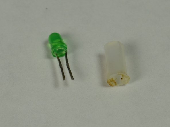

  9. Jumper Angelsounds JPD-100S Indicator Light Replacement: crwdns2935265:09crwdnd2935265:01crwdnd2935265:03crwdne2935265:0 Jumper Angelsounds JPD-100S Indicator Light Replacement: crwdns2935265:09crwdnd2935265:02crwdnd2935265:03crwdne2935265:0 Jumper Angelsounds JPD-100S Indicator Light Replacement: crwdns2935265:09crwdnd2935265:03crwdnd2935265:03crwdne2935265:0
    • Desoldering
    • If steam is created when the soldering iron is touched to a wet sponge then the soldering iron is hot enough.
    • Use the soldering iron and soldering vacuum to unsolder the indicator light leads.
    • Plastic spacer holding indicator light may burn.
