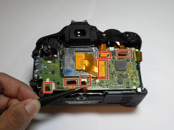

  • With tweezers, pinch the ends of the remaining orange ribbon cables, and gently pull these ends off of the motherboard.
  • Leave the other end of all ribbon cables attached to their components.
  • Take note of this black cable and where it connects to the motherboard. This is a fiber optic cable which is used for the camera flash. It will need to be reconnected after replacing the motherboard.
  • When reconnecting the fiber optic cable, simply push the black cable into the hole in the connector and push it all the way in.
