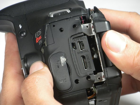

    • Peel away the rubber grip on the left side of the camera with your fingers.
    • The grip should feel like a thick sticker as it comes off.

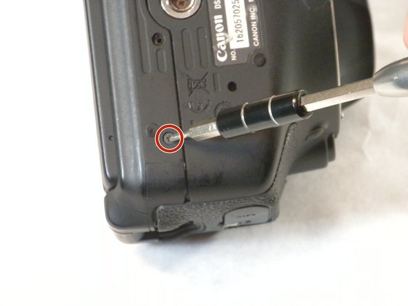

  5. Canon EOS Rebel T3i Motherboard Replacement: crwdns2935265:05crwdnd2935265:01crwdnd2935265:01crwdne2935265:0
    • Remove four 3 mm JIS #000 screws on the left side of the camera.

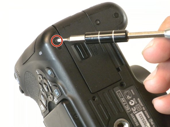

  6. Canon EOS Rebel T3i Motherboard Replacement: crwdns2935265:06crwdnd2935265:01crwdnd2935265:03crwdne2935265:0 Canon EOS Rebel T3i Motherboard Replacement: crwdns2935265:06crwdnd2935265:02crwdnd2935265:03crwdne2935265:0 Canon EOS Rebel T3i Motherboard Replacement: crwdns2935265:06crwdnd2935265:03crwdnd2935265:03crwdne2935265:0
    • Remove four 3 mm JIS #000 screws on the bottom of the camera.

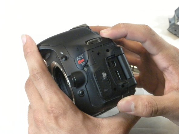

    • Remove two 3 mm JIS #000 screws on the right side of the camera.
  8. Canon EOS Rebel T3i Motherboard Replacement: crwdns2935265:08crwdnd2935265:01crwdnd2935265:02crwdne2935265:0 Canon EOS Rebel T3i Motherboard Replacement: crwdns2935265:08crwdnd2935265:02crwdnd2935265:02crwdne2935265:0
    • Remove the back of the camera by lifting from both the left and right sides.
    • Be careful not to break the orange and blue cables connecting the back panel of the camera to the motherboard.
