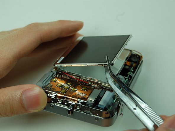

  • Use the tweezers to lift up the LCD screen.
  • Grab the LCD screen with the index finger and thumb, leave the ribbon attached to the screen and leave it on the side.
  • Be sure to be very gentle with the LCD screen.
