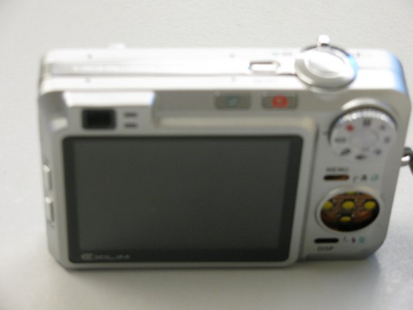

    • Remove the two screws on the side of the speakers with the Phillips 00 Screwdriver, on the portion of the camera that is a part of the back casing.
    • Label screws (where they came from and what step) and set aside in the sorting tray.

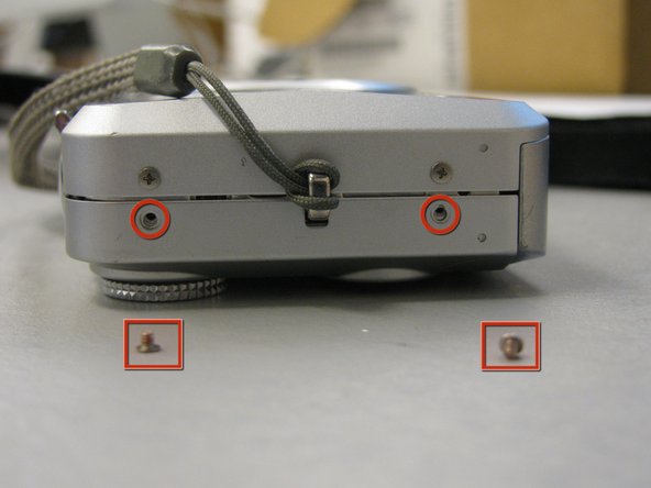

    • Remove the two back screws on the bottom of the camera on the same side as the LCD screen.
    • Note: The bottom screws are longer than the top ones, so label the screws accordingly for ease in reassembly. (See attached picture.)

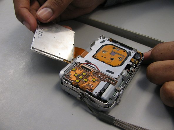

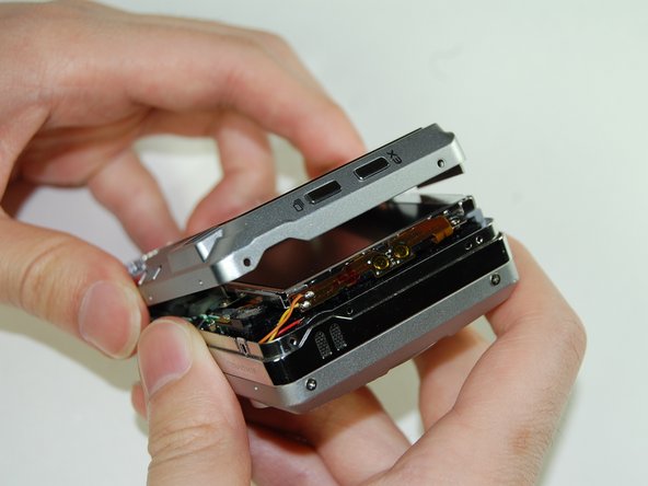

    • Once all screws have been removed, gently pry open the bottom casing.
    • Use the tweezers to carefully remove the ribbon from the LCD screen- NOT from the back casing itself.
    • Set the bottom casing aside.
    • Navigation button may fall out so be cautious of this and set aside if needed.

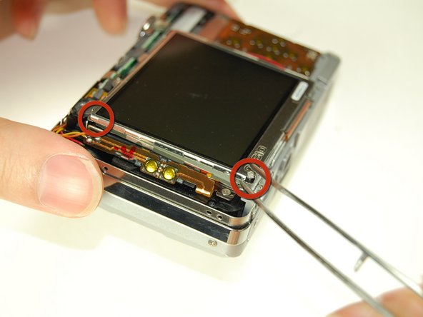

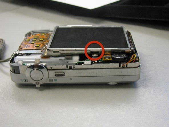

    • Use the tweezers to pry the LCD screen off from the openings. There are 5 spots that the tweezers can go in to pry the LCD screen off (see attached pictures).
    • There is a ribbon attached to the screen. Be sure not to pull this ribbon off the screen.

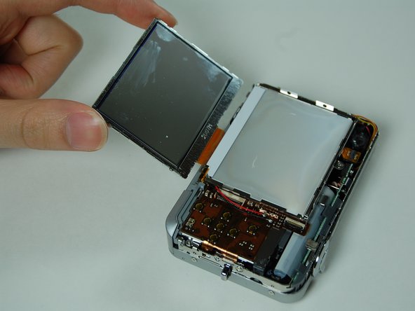

    • Use the tweezers to lift up the LCD screen.
    • Grab the LCD screen with the index finger and thumb, leave the ribbon attached to the screen and leave it on the side.
    • Be sure to be very gentle with the LCD screen.

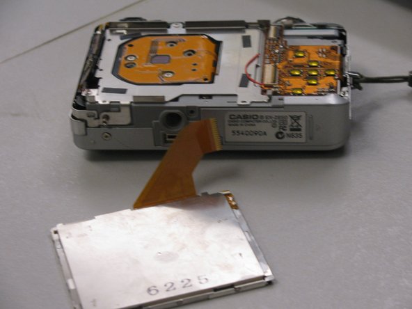

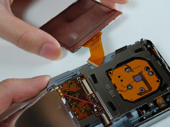

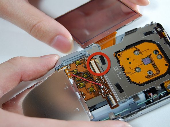

    • Use the tweezers to flip open the connectors holding the ribbon.
    • Pull out the LCD screen with the ribbon from the camera.
    • THIS STEP IS WHEN WHERE YOU SHOULD USE CAUTION AND BE VERY GENTLE!

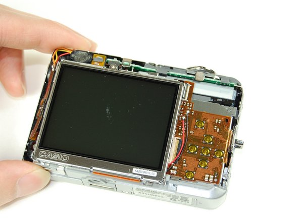

    • Your LCD screen is now detached.
    • Locate the replacement screen that you will now attach.

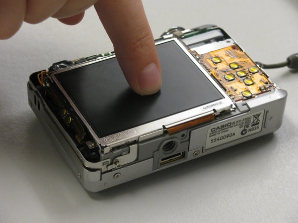

    • Make sure the LCD screen is firmly connected to the camera.
    • Slightly push the LCD screen down with one finger until you hear a click.
