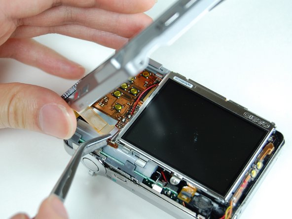

  • Once all screws have been removed, gently pry open the bottom casing.
  • Use the tweezers to carefully remove the ribbon from the LCD screen- NOT from the back casing itself.
  • Set the bottom casing aside.
  • Navigation button may fall out so be cautious of this and set aside if needed.
