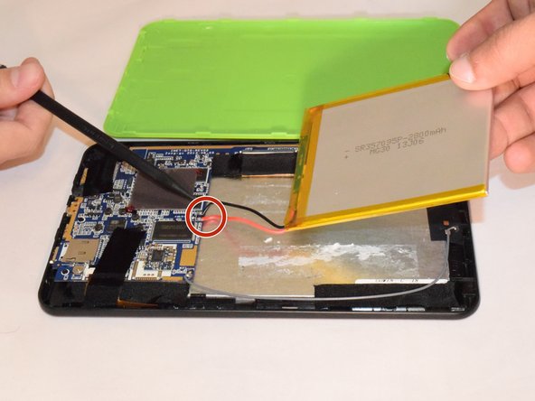

  • If replacing the battery, unplug the black and red wires gently from the hardware and take off the battery .
  • If not replacing it, do not disconnect the red and black wires.
  • If replacing the battery, you will need a soldering kit to reconnect the wires with the new battery after disconnecting the old battery.
  • How To Solder and Desolder Connections.
