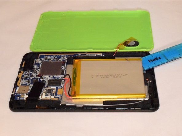

      • There are two screws on the side with the micro USB power port. Remove the two 2mm x 0.5mm screws with a Phillips #0 Screwdriver head.
    2. Ematic EGQ307 Battery Replacement: crwdns2935265:02crwdnd2935265:01crwdnd2935265:02crwdne2935265:0 Ematic EGQ307 Battery Replacement: crwdns2935265:02crwdnd2935265:02crwdnd2935265:02crwdne2935265:0
      • Pry off the plastic backing with the spudger and the plastic opening tools. Anything that can provide enough leverage and not conduct electricity will also work for this purpose.
      • Carefully separate the front and back plates because the wire that connects the speaker is connected to both the front and back plates.
    3. Ematic EGQ307 Battery Replacement: crwdns2935265:03crwdnd2935265:01crwdnd2935265:01crwdne2935265:0
      • 3. Once you pry off the plastic backing, you will expose the battery.

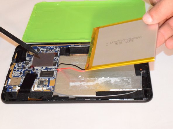

      • 4. Remove the tape holding the battery to the plastic frame. The battery is glued to the back of the LED. Pry the battery off the LED using a plastic card.
      • Do not bend or warp the battery. Even though the battery may not be working, it is still dangerous.
    5. Ematic EGQ307 Battery Replacement: crwdns2935265:05crwdnd2935265:01crwdnd2935265:01crwdne2935265:0
      • If replacing the battery, unplug the black and red wires gently from the hardware and take off the battery .
      • If not replacing it, do not disconnect the red and black wires.
      • If replacing the battery, you will need a soldering kit to reconnect the wires with the new battery after disconnecting the old battery.
      • How To Solder and Desolder Connections.
To reassemble your device, follow these instructions in reverse order. Note, you need to solder the battery wires onto the motherboard.
