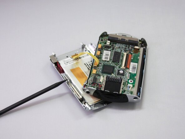

  • Insert the end of a spudger between the front and back cover and slide it around the edge to release the clips holding them together.
  • Pry them two halves but don't pull them apart as it is still connected by a cable.
