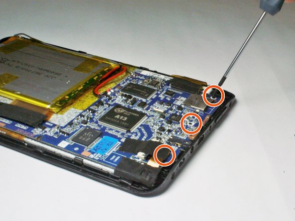

  • With the back cover off, unscrew each of the 3 screws 2.70 mm Phillips #00 holding down the circuit board.
  • NOTE: the left-most screw may be hidden underneath the black piece of tape, so you may need to first lift the corner of the tape up to expose it.
