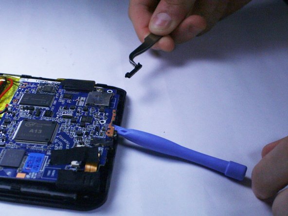

    5. Apex Tablet 7 Volume Control Button  Replacement: crwdns2935265:010crwdnd2935265:01crwdnd2935265:02crwdne2935265:0 Apex Tablet 7 Volume Control Button  Replacement: crwdns2935265:010crwdnd2935265:02crwdnd2935265:02crwdne2935265:0
      • If the button did not fall out on its own, push the circuit board up with one tool while gently pushing inwards on the volume button with another tool to dislodge it.
      • The button will fall out under the circuit board.
      • Hold the circuit board up with the prying tool and extract the loose button with tweezers.
