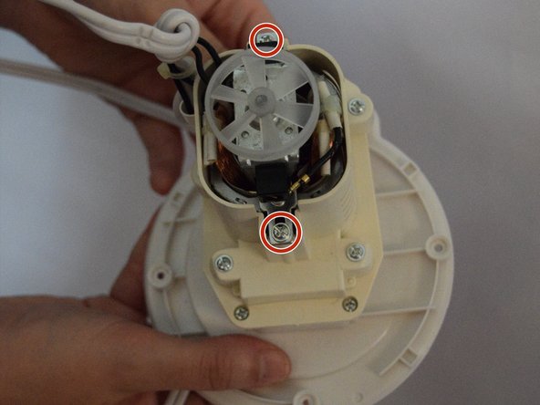

  • Remove the topmost two 5.5 mm Phillips #00 screws that hold the motor in the case.
  • Remove and replace the motor.
