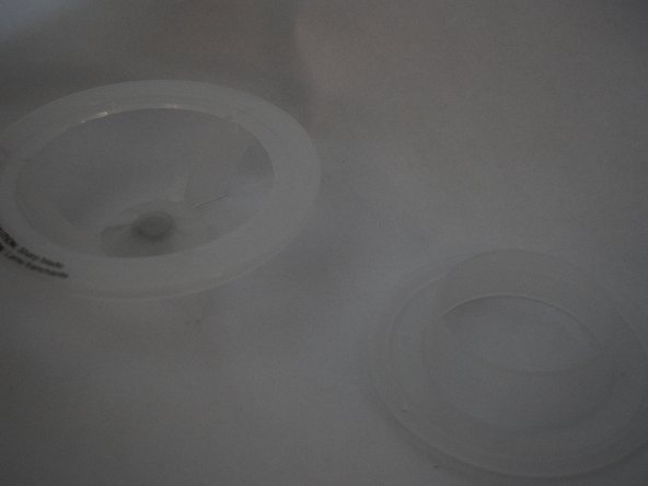

  3. Sunbeam Snow Cone Maker Motor Replacement: crwdns2935265:03crwdnd2935265:01crwdnd2935265:02crwdne2935265:0 Sunbeam Snow Cone Maker Motor Replacement: crwdns2935265:03crwdnd2935265:02crwdnd2935265:02crwdne2935265:0
    • To take the dasher apart, remove the three 5.5 mm Phillips #00 screws embedded in the plastic. **The 3rd screw is behind the hand in the picture
    • Carefully pull the two pieces apart.
    • When you've finished taking apart the dasher, you should have two parts that are shown in the second picture in this step.

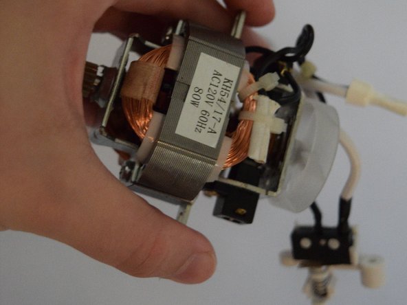

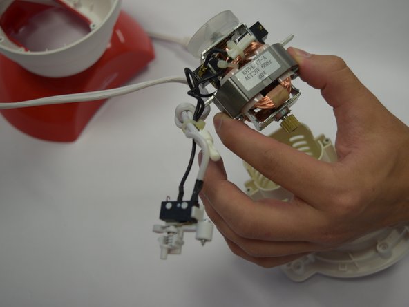

  8. Sunbeam Snow Cone Maker Motor Replacement: crwdns2935265:08crwdnd2935265:01crwdnd2935265:03crwdne2935265:0 Sunbeam Snow Cone Maker Motor Replacement: crwdns2935265:08crwdnd2935265:02crwdnd2935265:03crwdne2935265:0 Sunbeam Snow Cone Maker Motor Replacement: crwdns2935265:08crwdnd2935265:03crwdnd2935265:03crwdne2935265:0
    • Remove the topmost two 5.5 mm Phillips #00 screws that hold the motor in the case.
    • Remove and replace the motor.
