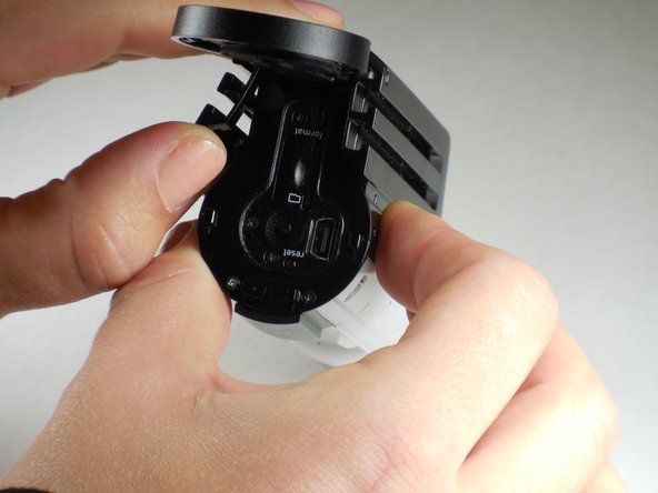

  • Using your thumb, pry sides outward on back of mount piece.
  • This will loosen mount piece for removal in proceeding step.
  • Side can be hard to pry outward. Using a flat tool such as a metal spudger, may help if your thumb is insufficient.
