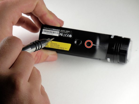

      • Using the phillips head screwdriver (PH000) locate and remove the 4.45mm (.175in) screw by the 180 degree graphic on the metal ring.
      • The screws in the camera are very small and can strip very easily. Apply consistent pressure when removing screws.

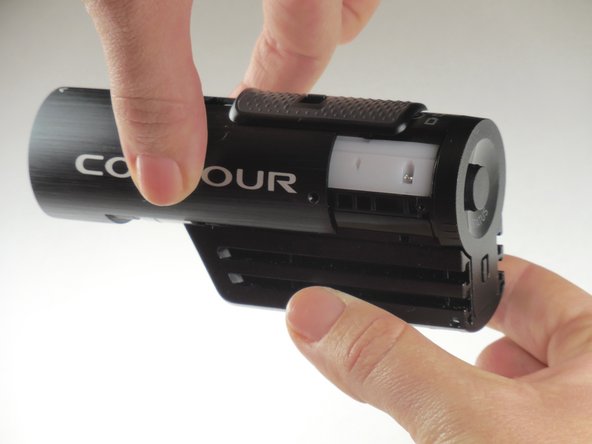

      • Using the phillips head screwdriver (PH000) remove the two 4.46mm (.175in) screws on each side near the back of the camera.

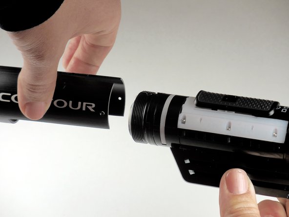

      • Grab the camera on both sides and slide the outer shell forward until completely removed.

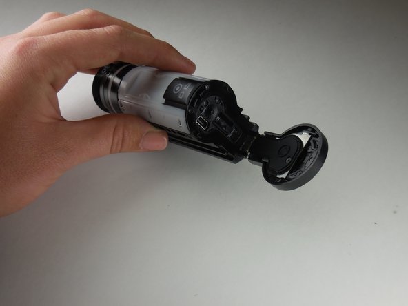

      • Open the back door by your thumb and index finger on sides of back door and pull upward.
