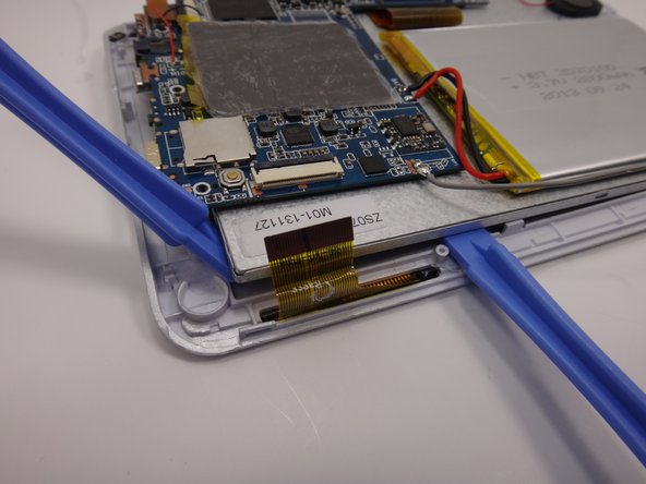

  • Using a second plastic opening tool, pry the adjacent side of the metal backing from the front casing/touch screen.
  • Pry close to the plastic tabs so you do not break them.
  • Leave the plastic opening tool in place underneath the metal backing to prop it up.
