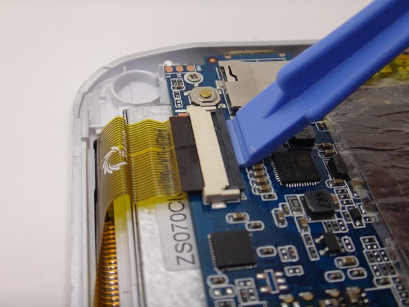

    1. Azpen A720 Touch Screen Replacement, Touch Screen: crwdns2935265:04crwdnd2935265:01crwdnd2935265:03crwdne2935265:0 Azpen A720 Touch Screen Replacement, Touch Screen: crwdns2935265:04crwdnd2935265:02crwdnd2935265:03crwdne2935265:0 Azpen A720 Touch Screen Replacement, Touch Screen: crwdns2935265:04crwdnd2935265:03crwdnd2935265:03crwdne2935265:0
      • Use the plastic opening tool to gently lift the release lever for the ZIF cable.
      • The ZIF connector is delicate. Be careful not to damage the tab!
    2. Azpen A720 Touch Screen Replacement: crwdns2935265:05crwdnd2935265:01crwdnd2935265:02crwdne2935265:0 Azpen A720 Touch Screen Replacement: crwdns2935265:05crwdnd2935265:02crwdnd2935265:02crwdne2935265:0
      • Gently remove the ZIF cable from the connector.

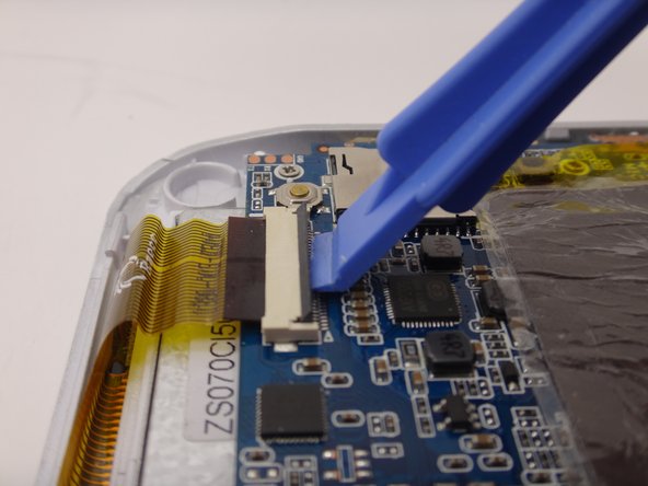

    3. Azpen A720 Touch Screen Replacement: crwdns2935265:06crwdnd2935265:01crwdnd2935265:02crwdne2935265:0 Azpen A720 Touch Screen Replacement: crwdns2935265:06crwdnd2935265:02crwdnd2935265:02crwdne2935265:0
      • Disconnect the second ZIF connector using the same method detailed earlier.

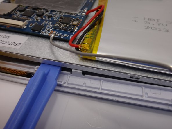

    7. Azpen A720 Touch Screen Replacement: crwdns2935265:010crwdnd2935265:01crwdnd2935265:02crwdne2935265:0 Azpen A720 Touch Screen Replacement: crwdns2935265:010crwdnd2935265:02crwdnd2935265:02crwdne2935265:0
      • Starting at the edge, use a plastic opening tool to carefully pry the front casing off of the metal backing.
      • Leave the plastic opening tool in place underneath the metal backing to prop it up.
      • Move the motherboard out of the way as needed.
    8. Azpen A720 Touch Screen Replacement: crwdns2935265:011crwdnd2935265:01crwdnd2935265:02crwdne2935265:0 Azpen A720 Touch Screen Replacement: crwdns2935265:011crwdnd2935265:02crwdnd2935265:02crwdne2935265:0
      • Using a second plastic opening tool, pry the adjacent side of the metal backing from the front casing/touch screen.
      • Pry close to the plastic tabs so you do not break them.
    9. Azpen A720 Touch Screen Replacement: crwdns2935265:012crwdnd2935265:01crwdnd2935265:01crwdne2935265:0
      • Remove the first plastic opening tool and use it to pry along the second edge.
      • Slide the tool along the edge until it is close the next tab, and gently pry the metal up.
    10. Azpen A720 Touch Screen Replacement: crwdns2935265:013crwdnd2935265:01crwdnd2935265:03crwdne2935265:0 Azpen A720 Touch Screen Replacement: crwdns2935265:013crwdnd2935265:02crwdnd2935265:03crwdne2935265:0 Azpen A720 Touch Screen Replacement: crwdns2935265:013crwdnd2935265:03crwdnd2935265:03crwdne2935265:0
      • Use a third plastic opening tool to pry at the corner of the tablet and pop off the metal backing.
    11. Azpen A720 Touch Screen Replacement: crwdns2935265:014crwdnd2935265:01crwdnd2935265:03crwdne2935265:0 Azpen A720 Touch Screen Replacement: crwdns2935265:014crwdnd2935265:02crwdnd2935265:03crwdne2935265:0 Azpen A720 Touch Screen Replacement: crwdns2935265:014crwdnd2935265:03crwdnd2935265:03crwdne2935265:0
      • Lift the metal backing from the propped edge to remove it from the front casing.
      • Replace the broken front touch screen and casing with a new one.
