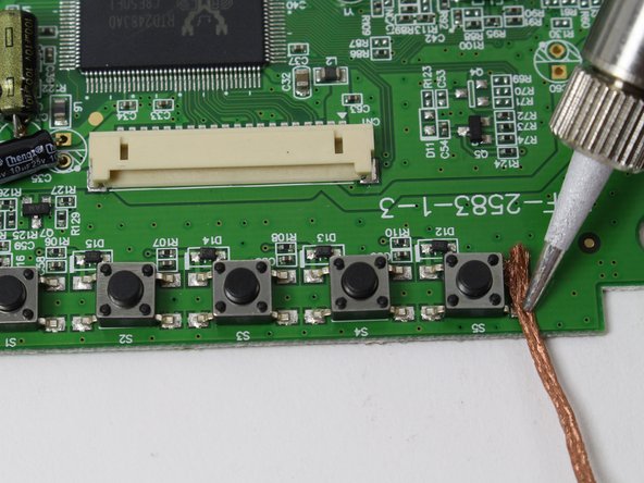

Oculus Rift DK1 Control Box Buttons Replacement, Desoldering Button: crwdns2935265:00crwdnd2935265:01crwdnd2935265:01crwdne2935265:0
Desoldering Button
  • For each button that needs to be replaced, use a soldering iron and soldering braid to desolder the four metal points.
  • Be careful! Soldering iron is hot.
