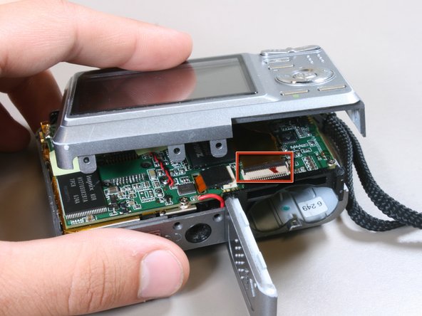

  • Locate the black tab where the LCD screen ribbon is attached to the logic board.
  • Using the plastic opening tool, flip the black tab towards the ribbon.
  • Gently pull the ribbon away from the logic board.
