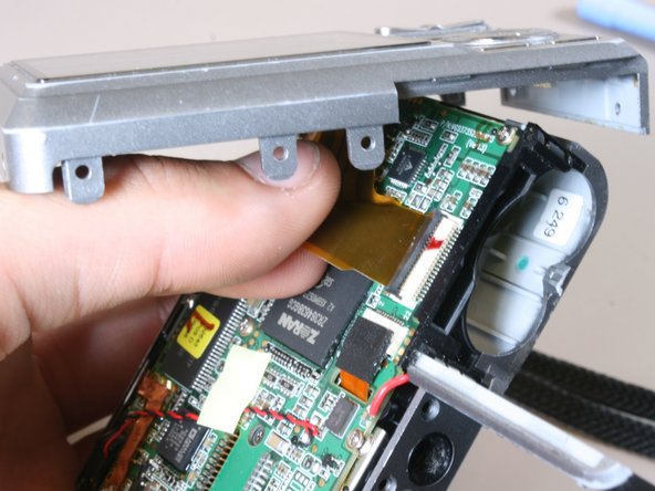

    • Slide open the battery door, then using the plastic opening tool, slightly open the side of the camera case.
    • Gently pull apart the cover from the body of the camera.
    • Do not pull the cover off completely because it is still attached to the logic board.

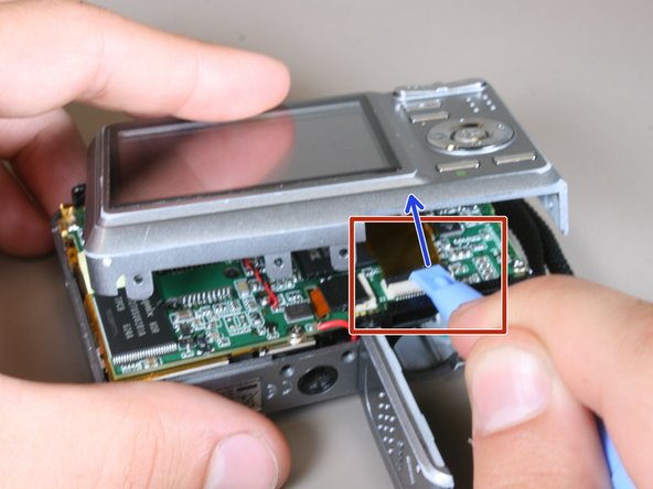

    • Locate the black tab where the LCD screen ribbon is attached to the logic board.
    • Using the plastic opening tool, flip the black tab towards the ribbon.
    • Gently pull the ribbon away from the logic board.

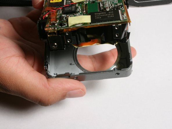

    • Using a #00 screw driver, remove the screw on the bottom of the logic board just above the tripod attachment.
    • Gently pull the front of the case away from the insides of the camera.

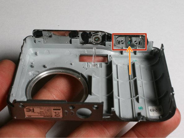

    • Locate the button that will be removed.
    • To remove: gently push outward on the button from the inside of the casing.
  9. Polaroid i533 Button Replacement: crwdns2935265:09crwdnd2935265:01crwdnd2935265:01crwdne2935265:0
    • Remove spring from bottom of broken button.
    • Remove and replace defective button.
    • Do not lose spring as it is needed for replacement button.
