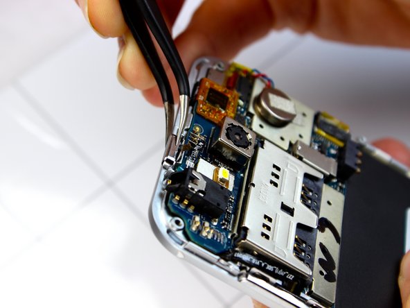

Removing Power Button
  • Locate the silver power button at the top of the phone.
  • Use the precision tweezers to slide the power button out of the groove.
  • When replacing the power button align the flat side of the button to the silver edge of the display with the rounded edge facing the black frame.
